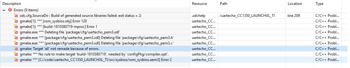

I  am using CC1350 launchpad and i tried to build TI-RTOS CC1350 lauchpad example which is about ADC
 Problems Log
Description Resource Path Location Type
gmake: *** [../src/sysbios/rom_sysbios.aem3] Error 2 App C/C++ Problem
gmake: *** [build-1536868849] Error 2 App C/C++ Problem
gmake: *** [C:/App/src/sysbios/rom_sysbios.aem3] Error 2 App C/C++ Problem
gmake: Target 'all' not remade because of errors. App C/C++ Problem
gmake[1]: *** [build-1536868849-inproc] Error 1 App C/C++ Problem
gmake[1]: *** [m3_Hwi_asm.obj] Error -1073741502 App C/C++ Problem
gmake[1]: *** [rom_sysbios.obj] Error 128 App C/C++ Problem
gmake[1]: *** [rom_sysbios.obj] Error 258 App C/C++ Problem
gmake[1]: Target 'all' not remade because of errors. App C/C++ Problem
xdc.cfg.SourceDir : Build of generated source libraries failed: exit status = 2: .xdchelp /App line 209 C/C++ Problem
xdctools_3_32_01_22_core\gmake.exe: *** [package/cfg/adcsinglechannel_pem3.xdl] Deleting file `package/cfg/adcsinglechannel_pem3.c' App C/C++ Problem
xdctools_3_32_01_22_core\gmake.exe: *** [package/cfg/adcsinglechannel_pem3.xdl] Deleting file `package/cfg/adcsinglechannel_pem3.h' App C/C++ Problem
xdctools_3_32_01_22_core\gmake.exe: *** Deleting file `package/cfg/adcsinglechannel_pem3.xdl' App C/C++ Problem

  • erdem simsek said:
    I installed the CCS v7 in my computer and i tried to compile a sample project. During compiling process, i got error messages. Because of that, the compiling was aborted.
    It seems that you are trying to build the "Empty project" template in CCS. Similar to this post, support for creating and building simple empty projects for CC1350 is not clean in CCS and is not the recommended way of starting development. Instead it is recommended to begin with the CC13x0 SDK and the examples included with it.
    erdem simsek said:
    error: xdc.cfg.SourceDir: "C:/ti/xdctools_3_32_01_22_core/packages/xdc/cfg/SourceDir.xs", line 209: xdc.cfg.SourceDir : Build of generated source libraries failed: exit status = 2:
    Some common reasons for the above error are described in this wiki page. Could you please check if any of those apply to your situation?
    If it does not, I would recommend starting with the CC13X0 SDK (which also includes TI-RTOS), importing the examples from there and following their recommended build flow.
    Hope this helps get you going in the right direction.
  • I could not find my problem. I tried what you said but i failed.
    what is your suggestion for my problem?
    I am sure that, there is no any non-ascii character in project path and install directory.
    I will try to install TI-RTOS_2.20 for CC13xx in IAR Embedded Workbench. I hope that, it will work
  • WinAVR is installed in my computer. Because of that, i could not compile the code. When i uninstalled the WinAVR, my problem is solved.
    Are there any way to use TI-RTOS and WinAVR together?
    Yes that is one of the toolchains that is known to cause a conflict, as per this wiki link.
    Unfortunately this is still a known open issue, and I don't have a timeline at this point on when this will be addressed. You can still have WinAVR installed, you just need to ensure that those tools are removed from the system PATH or that they appear after the CCS paths.
