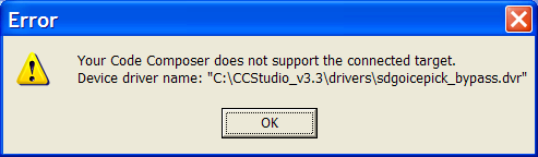

I have a problem trying to make CCStudio 3.3 work with Spectrum Digital TMS320DM6437 EVM board.
I do the following:
What should I do to use CCStudio v3.3 with TMS320DM6437 EVM board? Included manuals didn’t help.

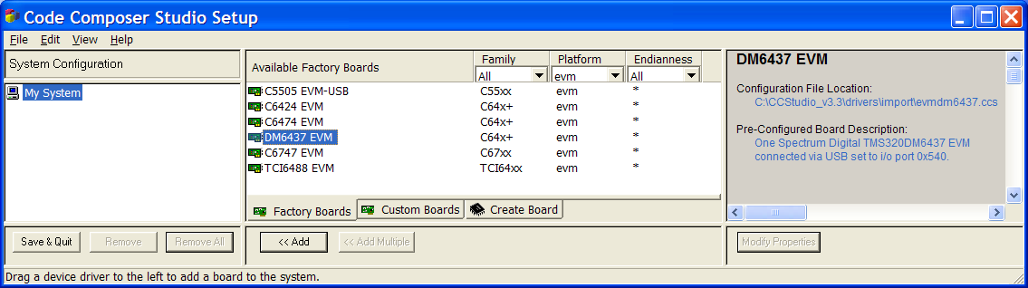

Please completely uninstall your existing CCSv3.3 installation and any related drivers. After you have done that, please do the following (all under administrative rights):
1) Download and install the latest CCSV3.3 version. You can download it from: https://www.ti.com/licreg/docs/swlicexportcontrol.tsp?form_type=2&prod_no=CCS_3.3.83.20_Platinum.zip&ref_url=https://software-dl.ti.com/dsps/dsps_public_sw/sdo_ccstudio/CCSv3/CCS_3_3/
2) Download and install the latest SD drivers from SD: http://support.spectrumdigital.com/ccs33/
See if the above works for you

Thanks, Ki, it worked!
For those who faced the same problem:
1. CCStudio 3.3 version that comes with the Spectrum Digital TMS320DM6437 EMV board doesn’t support drivers from http://support.spectrumdigital.com/ccs33 (setupCCSPlatinum_v30330.zip). I can’t name the exact CCStudio version since it doesn’t start, but the cc_app.exe file version is 5.98.0.219.
CCStudio crashes saying “Your Code Composer does not support the connected target. Device driver name: "C:\CCStudio_v3.3\drivers\sdgoicepick_bypass.dvr”.

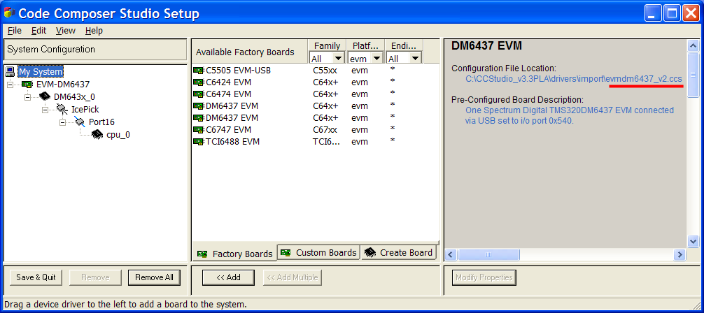

2. CCStudio v3.3.83.20 Platinum (downloaded from www.ti.com) works only with the DM6437 EVM configuration from http://support.spectrumdigital.com/ccs33. It doesn't work with the configuration from the included Spectrum Digital CD. Although this configuration is marked as version 2 (evmdm6437_v2.css).
CCStudio crashes saying “Unable to load C:\CCStudio_v3.3PLA\drivers\sdgoicepick_dsk64p.dvr”.
