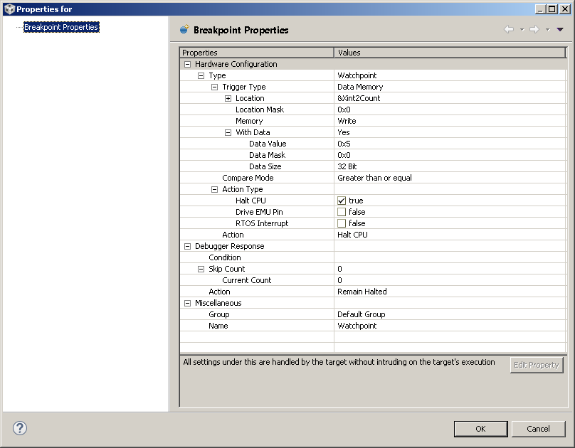

    With the non-OS example when a breakpoint was set at the start of an interrupt handler with a skip-count of 5, the skip-count worked as expected. However, realized that with either a hardware or software breakpoint the skip count is handled by the debugger. This means that each time the breakpoint is hit the debugger has to increment the skip count and decide if to resume the target or leave the target halted. Therefore, use of a skip-count is intrusive on the target execution. A LSA watching the GPIO which was driven low during the interrupt handlers showed the act of using a skip-count caused the target to be halted for between 20 to 30 milliseconds before being resumed. Where the overhead to handle the skip-count will probably vary depending upon the type of debug probe and speed of the PC running the CCS debugger.
    In the example I was using there are 32-bit integer variables which are incremented by the interrupt handlers on every call. Found that could setup a hardware watchpoint to trigger on the writes to the variables, and use a compare mode to trigger when the value was >=5. Since the variable is initialized to zero and incremented by one for every interrupt effectively gives a skip-count of 5 but such that the compare is handled by the target without intruding on the target's execution. An example for a hardware watchpoint set on the 32-bit Xint2Count variable incremented by an interrupt handler:
    The LSA confirmed that the interrupt was run for 5 times at full speed,  before the target was halted in the debugger when the Xint2Count variable got to the value of 5.
    Would such a hardware watchpoint work-around your problem with the skip-count?
