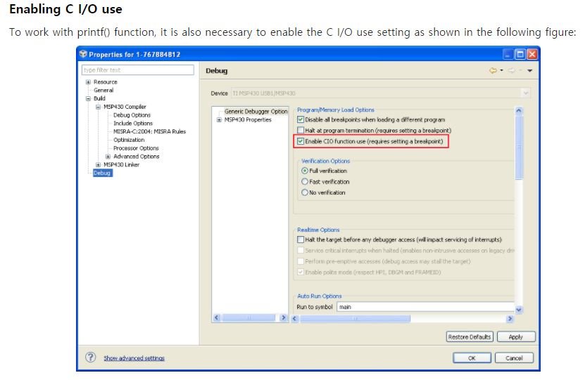

I am trying to use printf with MSP430FR5969 board.
I have tested with basic helloworld project and it works well.
Now I am trying to use printf in my project I am now working on, because I want to use printf for logging my project.
But the CIO console is not showing up when I run the other project.
What is this problem about?
how can I see CIO console?

    Thank you for the reply.
    I tried the steps written in this page, processors.wiki.ti.com/.../Printf_support_for_MSP430_CCSTUDIO_compiler but it is still not working.
    I checked enabling CIO, but still does not showing up.
    Do you have another recommendation with this problem?
    Mirae

  • I downloaded FreeRTOS and ran the demo. To get it to build I had to change the printf support in the options to full from minimal. Printf is not outputting anything for me either. I stepped through the code and I can see that the project includes its own version of printf and not the one that comes with the TI Compiler C runtime support library. I won't be able to help you with using that. If you want to use that then someone from FreeRTOS would need to help. Maybe a community member in the MSP430 forum might know how it works.
    I was able to get printf working by doing the following:
    put the printf support back to minimal so that it fits in memory (project properties, build->MSP430 Compiler->Advanced options->language options)
    exclude the printf-stdarg.c file from the project (right click on it and select exclude from build).
    set the heap to 320
    build
    comment out the sprintf lines that cause build errors
    build again
    run
