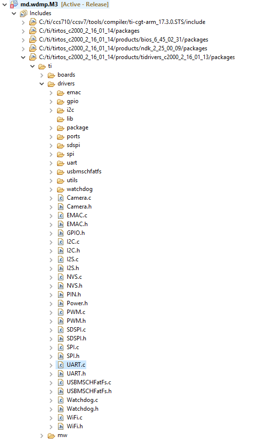

In one of my code files I include the following file:
#include <ti/drivers/UART.h>
If I Ctrl-Click on the file name CCS appropriately opens the file.  However when I go to compile it gives the #1965 error that it cannot find that file.
The include is automatically handled by the RTOS and expands to:
"C:/ti/tirtos_c2000_2_16_01_14/products/tidrivers_c2000_2_16_01_13/packages"
The full path of the file is:
"C:\ti\tirtos_c2000_2_16_01_14\products\tidrivers_c2000_2_16_01_13\packages\ti\drivers\UART.h"
If I expand out the tree under the includes I can locate the appropriate file as well.

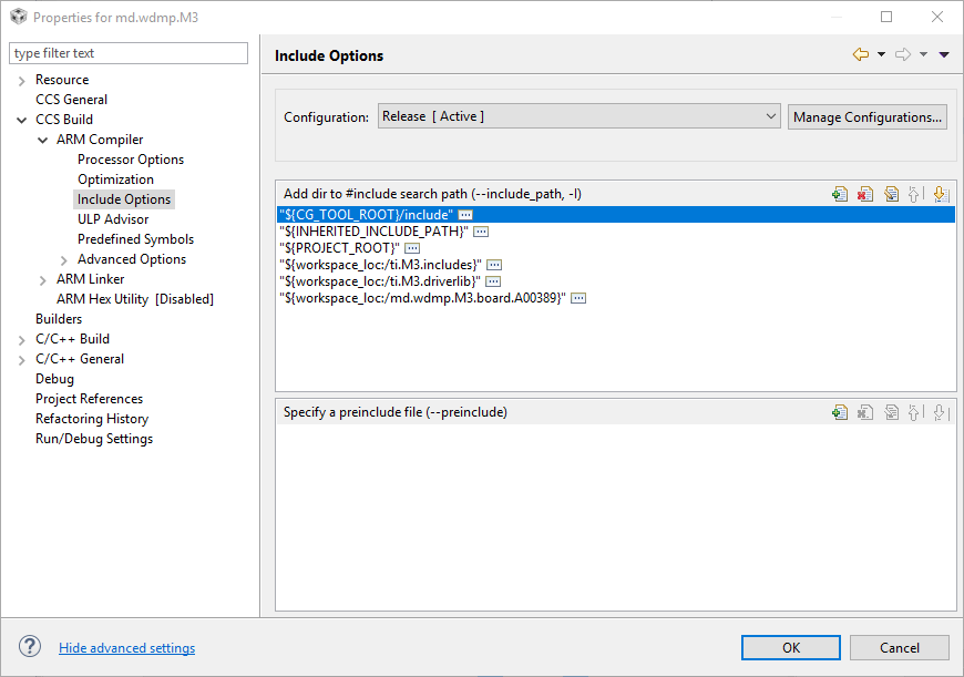

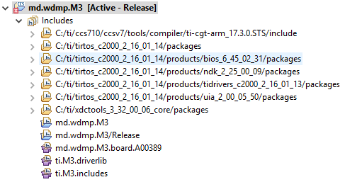

  • I have also included the tree view and include options.
  • Thanks John. I believe what is happening is related to this known issue mentioned my Aarti in the below post:
    e2e.ti.com/.../601227
    Basically that include path that are "inherited" are not being passed to the build tools. This can be seen in the build output. Try explicitly adding the include search path in the build options
    ki
