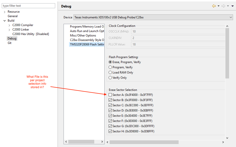

I have an implementation of a bootloader and main code. The bootloader takes up sector A and the main code fills the other sectors.
By default CCS v7.2 will erase all sectors when starting a debug session and this ends up erasing either the bootloader or the main code.
I found this select box in the image below which works, however it does not modify any of the normal CCS project files (.ccsproject, .cproject, .project) which are commited to git
So whenever someone goes to cloned the repo again these setting get lost resulting in much time lost and frustration.
It appears that this information may be contained in the files .launches/xxx.launch directory however these are not recommended to be checked to source control according to a rather old wiki http://processors.wiki.ti.com/index.php/Source_control_with_CCS
Can anyone shed light on if these are the correct files for these flash sector settings and if we'll end up with constant merge conflicts if these files are checked in?
  • Thomas,
    You are correct that these settings are stored in the "Launch".  We generally advise people not to check in the launch as it contains behavior settings that are more personal preference.  However if you need to share the Flash settings then checking in the Launch is the way to go.  You might want to tell people to make it writable after so that they can modify it without having to check out.
    In my case the project name was Example_2806xFlash and the file containing the settings is in the ./launches folder and is called Example_2806xFlash.LAUNCH
    Basically anything you can set from the Debug Configurations dialog gets stored in a launch.
    John

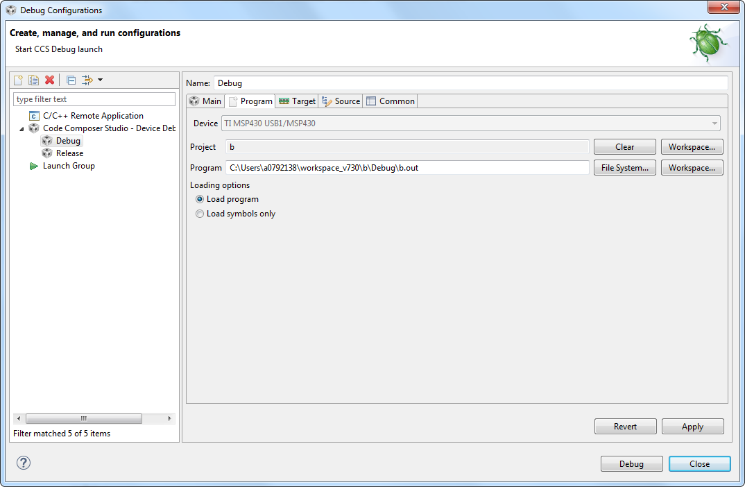

  • Thomas,
    It is possible to have multiple debug configurations / launches.
    If you go into the Debug Configuration dialog you can copy an existing one.  You can then set the properties to point to the output of a specific build configuration.
    Here I have created Debug and Release "debug" configurations that correspond to my build configurations:
    Once they have been launched once they will show up on the debug button drop down menu:
    The disadvantage of this method is that you would need to build your project and then click on the debug action.  If you click on the bug button itself it will still launch the one that is associated with the project (unless you delete it).
