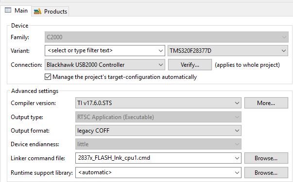

I can specify my USB2000 or TI XDS110 in the project properties page:
If I verify the connection:

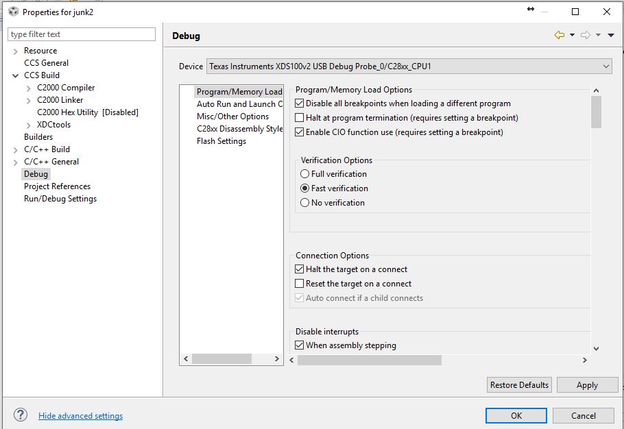

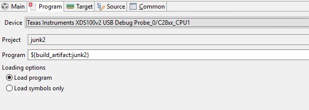

When I try to selected a debug device in a debug configuration:
XDS100v2's are my only choices.  My emulators do show up in Device Manager.
CCS 7.2.0.00013 on Win 10
    It looks like the debug configuration does not match the project you showed in your first screenshot. If that the screenshot for the "junk2" project? Also what does the "Debug" part of the project properties look like?
    ki
  • Everything is the junk2 project.  Here is a shot of the debug properties for junk2.  Again, the only choices are the XDS100's.

  • I was more interested in the dropdown list for the connection type in the basic gui view:
    If you can't get to this GUI view, then CCS is unable to recognize your ccxml file as valid... which would make me suspect you are missing some required components.
    ki
  • Sorry.....all all the emulator types are listed. If have been able to get the USB2000 to be shown in the debug configuration by deleting the existing configuration and re-creating it. I now get a connection error from the Blackhawk USB2000 Controller_0/IcePicl_C_0; Error connecting to the target: Error - 150. I am going to check the jumper settings on the ControlCard to see if this is the cause. One step closer.
  • By deleting the debug configuration and re-creating it I was able to make my emulator appear as the device in the debug configuration. Setting the ASW1 switch to the appropriate setting allowed my to connect and debug my application. Case closed. Thankx...
