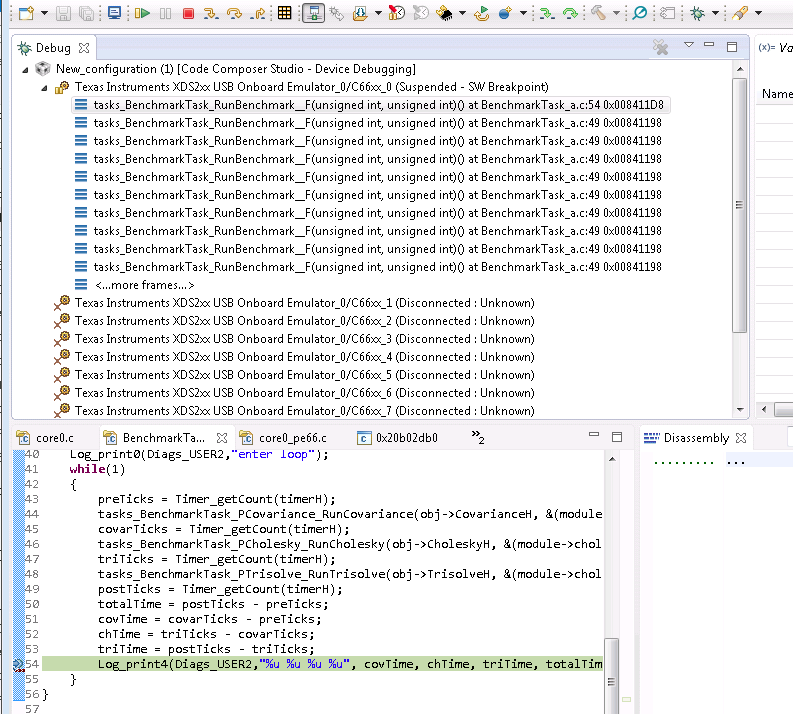

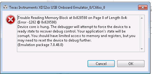

I have been debugging a benchmark program I have written on one of the C66 cores of the EVMK2H.
On the first load everything appears to be OK. But after one iteration of my benchmarking loop the debugger appears to have issues controlling the device. After hitting halt / pause I get the following popup:
Trouble Halting Target CPU:
(Error -1202 @ 0x0)
Device core is hung. The debugger will attempt to force the device to a ready state to recover debug control. Your application's state will be corrupt. You should have limited access to memory and registers, but you may need to reset the device to debug further.
(Emulation package 7.0.48.0)

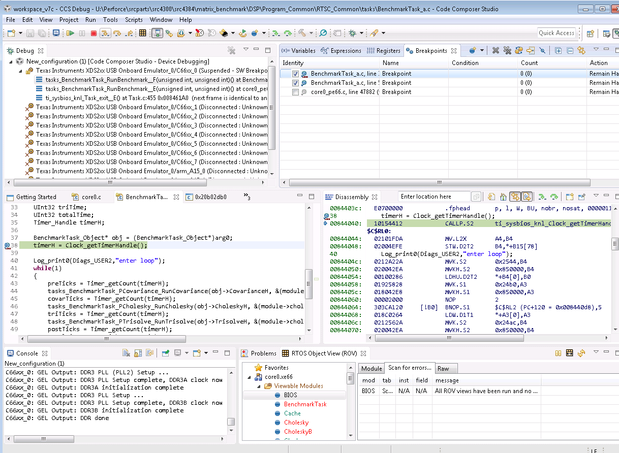

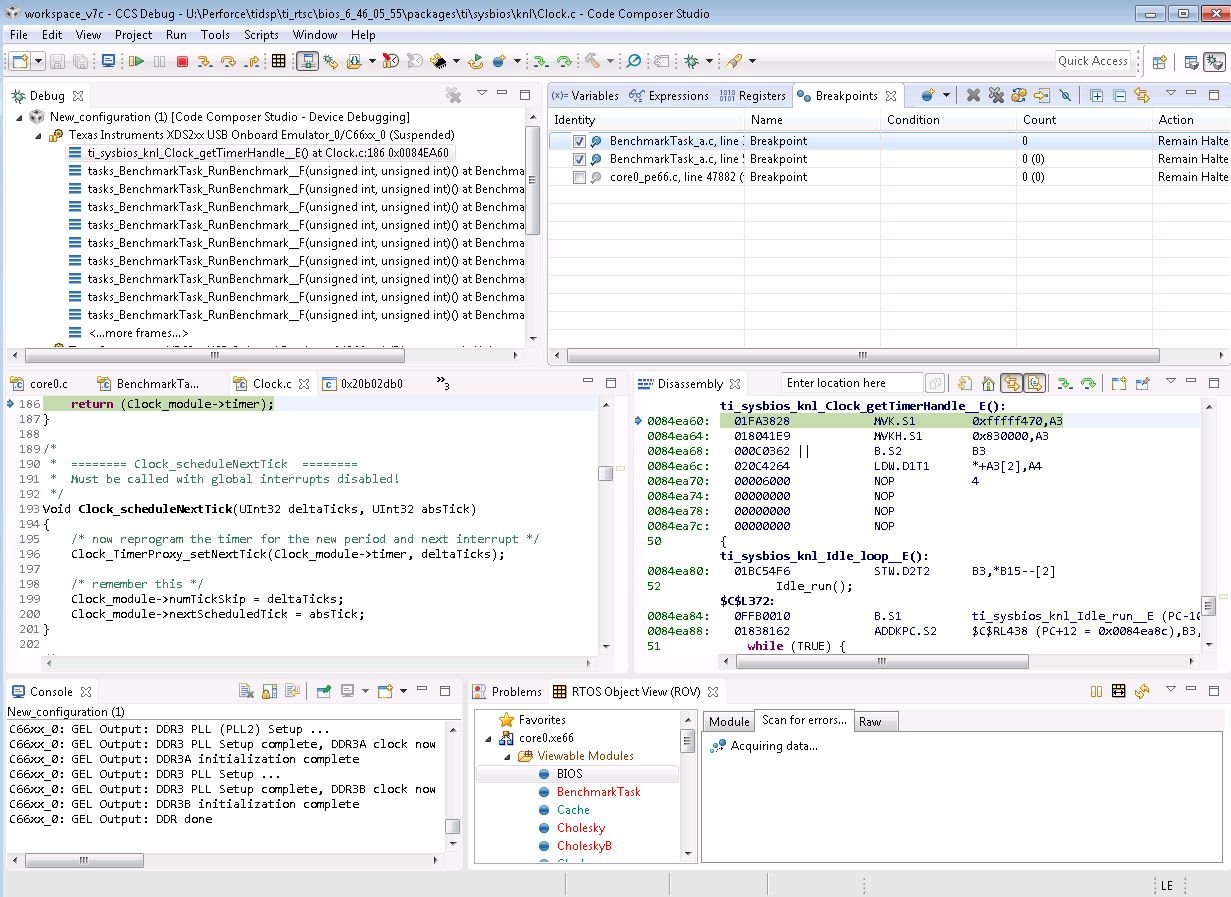

Here is the console output:
C66xx_0: GEL Output:
Connecting Target...
C66xx_0: GEL Output: TCI6638K2K GEL file Ver is 1.60000002
C66xx_0: GEL Output: Detected PLL bypass enabled: SECCTL[BYPASS] = 0x00800000
C66xx_0: GEL Output: (2a) MAINPLLCTL1 = 0x00000040
C66xx_0: GEL Output: (2b) PLLCTL = 0x00000048
C66xx_0: GEL Output: (2c) PLLCTL = 0x00000048
C66xx_0: GEL Output: (2d) Delay...
C66xx_0: GEL Output: (2e) SECCTL = 0x00810000
C66xx_0: GEL Output: (2f) PLLCTL = 0x0000004A
C66xx_0: GEL Output: (2g) Delay...
C66xx_0: GEL Output: (2h) PLLCTL = 0x00000048
C66xx_0: GEL Output: (4)PLLM[PLLM] = 0x0000000F
C66xx_0: GEL Output: MAINPLLCTL0 = 0x05000000
C66xx_0: GEL Output: (5) MAINPLLCTL0 = 0x07000000
C66xx_0: GEL Output: (5) MAINPLLCTL1 = 0x00000040
C66xx_0: GEL Output: (6) MAINPLLCTL0 = 0x07000000
C66xx_0: GEL Output: (7) SECCTL = 0x00890000
C66xx_0: GEL Output: (8a) Delay...
C66xx_0: GEL Output: PLL1_DIV3 = 0x00008002
C66xx_0: GEL Output: PLL1_DIV4 = 0x00008004
C66xx_0: GEL Output: PLL1_DIV7 = 0x00000000
C66xx_0: GEL Output: (8d/e) Delay...
C66xx_0: GEL Output: (10) Delay...
C66xx_0: GEL Output: (12) Delay...
C66xx_0: GEL Output: (13) SECCTL = 0x00090000
C66xx_0: GEL Output: (Delay...
C66xx_0: GEL Output: (14) PLLCTL = 0x00000041
C66xx_0: GEL Output: PLL has been configured (CLKIN * PLLM / PLLD / PLLOD = PLLOUT):
C66xx_0: GEL Output: PLL has been configured (122.879997 MHz * 16 / 1 / 2 = 983.039978 MHz)
C66xx_0: GEL Output: Power on all PSC modules and DSP domains...
C66xx_0: GEL Output: Set_PSC_State... Timeout Error #03 pd=2, md=9!
C66xx_0: GEL Output: Set_PSC_State... Timeout Error #03 pd=17, md=25!
C66xx_0: GEL Output: Set_PSC_State... Timeout Error #03 pd=17, md=26!
C66xx_0: GEL Output: Set_PSC_State... Timeout Error #03 pd=18, md=27!
C66xx_0: GEL Output: Set_PSC_State... Timeout Error #03 pd=19, md=28!
C66xx_0: GEL Output: Set_PSC_State... Timeout Error #03 pd=19, md=29!
C66xx_0: GEL Output: Set_PSC_State... Timeout Error #03 pd=20, md=30!
C66xx_0: GEL Output: Set_PSC_State... Timeout Error #03 pd=20, md=31!
C66xx_0: GEL Output: Set_PSC_State... Timeout Error #03 pd=20, md=32!
C66xx_0: GEL Output: Set_PSC_State... Timeout Error #03 pd=20, md=33!
C66xx_0: GEL Output: Set_PSC_State... Timeout Error #03 pd=21, md=34!
C66xx_0: GEL Output: Set_PSC_State... Timeout Error #03 pd=22, md=35!
C66xx_0: GEL Output: Set_PSC_State... Timeout Error #03 pd=22, md=36!
C66xx_0: GEL Output: Set_PSC_State... Timeout Error #03 pd=23, md=37!
C66xx_0: GEL Output: Set_PSC_State... Timeout Error #03 pd=23, md=38!
C66xx_0: GEL Output: Set_PSC_State... Timeout Error #03 pd=24, md=39!
C66xx_0: GEL Output: Set_PSC_State... Timeout Error #03 pd=24, md=40!
C66xx_0: GEL Output: Set_PSC_State... Timeout Error #03 pd=24, md=41!
C66xx_0: GEL Output: Set_PSC_State... Timeout Error #03 pd=24, md=42!
C66xx_0: GEL Output: Set_PSC_State... Timeout Error #03 pd=25, md=43!
C66xx_0: GEL Output: Set_PSC_State... Timeout Error #03 pd=25, md=44!
C66xx_0: GEL Output: Set_PSC_State... Timeout Error #03 pd=25, md=45!
C66xx_0: GEL Output: Set_PSC_State... Timeout Error #03 pd=25, md=46!
C66xx_0: GEL Output: Set_PSC_State... Timeout Error #03 pd=26, md=47!
C66xx_0: GEL Output: Set_PSC_State... Timeout Error #03 pd=27, md=48!
C66xx_0: GEL Output: Power on all PSC modules and DSP domains... Done.
C66xx_0: GEL Output: WARNING: SYSCLK is the input to the PA PLL.
C66xx_0: GEL Output: Completed PA PLL Setup
C66xx_0: GEL Output: PAPLLCTL0 - before: 0x0x098804C0     after: 0x0x09080500
C66xx_0: GEL Output: PAPLLCTL1 - before: 0x0x00000040     after: 0x0x00002040
C66xx_0: GEL Output: DDR begin
C66xx_0: GEL Output: XMC setup complete.
C66xx_0: GEL Output: DDR3 PLL (PLL2) Setup ...
C66xx_0: GEL Output: DDR3 PLL Setup complete, DDR3A clock now running at 666 MHz.
C66xx_0: GEL Output: DDR3A initialization complete
C66xx_0: GEL Output: DDR3 PLL Setup ...
C66xx_0: GEL Output: DDR3 PLL Setup complete, DDR3B clock now running at 800MHz.
C66xx_0: GEL Output: DDR3B initialization complete
C66xx_0: GEL Output: DDR done
C66xx_0: Trouble Halting Target CPU: (Error -1060 @ 0x0) Device is not responding to the request. Reset the device, and retry the operation. If error persists, confirm configuration, power-cycle the board, and/or try more reliable JTAG settings (e.g. lower TCLK). (Emulation package 7.0.48.0)
C66xx_0: Trouble Halting Target CPU: (Error -1202 @ 0x0) Device core is hung. The debugger will attempt to force the device to a ready state to recover debug control. Your application's state will be corrupt. You should have limited access to memory and registers, but you may need to reset the device to debug further. (Emulation package 7.0.48.0)
Here is my benchmark loop:
Void BenchmarkTask_RunBenchmark(UArg arg0, UArg arg1)
    algorithms_ICovariance_dataCell_s weights[16];   // hard coded size!!!
    UInt32 preTicks;
    UInt32 covarTicks;
    UInt32 triTicks;
    UInt32 postTicks;
    UInt32 covTime;
    UInt32 chTime;
    UInt32 triTime;
    UInt32 totalTime;
    Timer_Handle timerH;
    BenchmarkTask_Object* obj = (BenchmarkTask_Object*)arg0;
    timerH = Clock_getTimerHandle();
    Log_print0(Diags_USER2,"enter loop");
    while(1)
        preTicks = Timer_getCount(timerH);
        tasks_BenchmarkTask_PCovariance_RunCovariance(obj->CovarianceH, &(module->inputData[0]), &(module->choleskyData[0]));
        covarTicks = Timer_getCount(timerH);
        tasks_BenchmarkTask_PCholesky_RunCholesky(obj->CholeskyH, &(module->choleskyData[0]));
        triTicks = Timer_getCount(timerH);
        tasks_BenchmarkTask_PTrisolve_RunTrisolve(obj->TrisolveH, &(module->choleskyData[0]), &(weights[0]), &(module->outputData[0]));
        postTicks = Timer_getCount(timerH);
        totalTime = postTicks - preTicks;
        covTime = covarTicks - preTicks;
        chTime = triTicks - covarTicks;
        triTime = postTicks - triTicks;
        Log_print4(Diags_USER2,"%u %u %u %u", covTime, chTime, triTime, totalTime);

    When I step through my code all seems ok until I step into this line:
    I placed a breakpoint on that line. and when I run up to that point I get the following:
    Then i click the "step into" button and the following happens:
    Why does stepping into a SYS/BIOS function call cause the stack trace to go out the window?

    Can you share "BenchmarkTask_a.c" file ? I want to see the code at and around line 38 that is causing the following warning.
    "BenchmarkTask_a.c", line 38: warning: a value of type "ti_sysbios_knl_Clock_TimerProxy_Handle" cannot be assigned to an entity of type "ti_sysbios_hal_Timer_Handle"

  • Ok, so I think I found the code that was causing the warning:
    There is a type mismatch here. The Clock timer proxy is "ti.sysbios.timers.timer64.Timer" and the handle returned by Clock_getTimerHandle() is the handle to that type of Timer object. I believe you are including "ti/sysbios/hal/Timer.h" in your benchmark app. A Timer64 timer object handle cannot be used with Hal Timer module APIs. If used, then it can cause a dereference to an invalid  address and I guess could also result in loss of debug connection.
    Can you change the Timer.h included in your benchmark app from "ti/sysbios/hal/Timer.h" to "ti/sysbios/timers/timer64/Timer.h" ?
