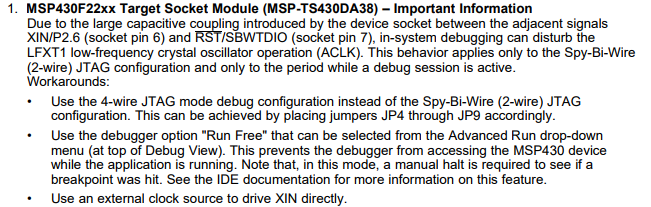

  • David Cheung said:
    I have MSP430-FET debugger with a MSP-TS430DA38 board with a MSP430G2955 microcontroller. It works fine when in 4-wire JTAG mode. When I moved the JP4-JP9 jumpers to position 1-2 for testing the SpyBiWire 2 wire mode.
    From the Hardware FAQs section of the MSP430 Hardware Tools User's Guide:
    Spy-Bi-Wire can be affected by capacitance on the SBWTDIO pin, so the above note may explain why Spy-Bi-Wire is not working.
    In the CCS Target Configuration there is an option for the JTAG/SBW Speed, and selecting "Slow" may allow Spy-Bi-Wire to work in your case:
