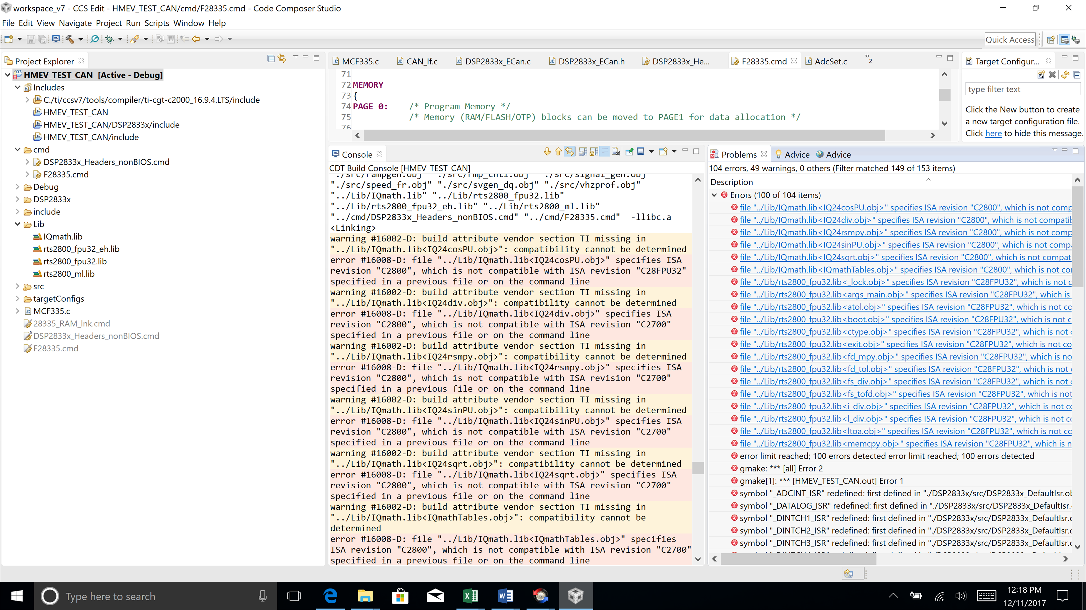

How to resolve the following error and I am attaching the my screenshot as well as.
error #16008-D: file "../Lib/IQmath.lib<IQ24cosPU.obj>" specifies ISA revision "C2800", which is not compatible with ISA revision "C28FPU32" specified in a previous file or on the command line
Thanks!
The reason for this error is explained in this FAQ. In summary the options used to build the source files should be the same as the ones used to build the libraries that are linked to the project (both rts and IQmath libraries).
For the F28335, the recommended options are -v28 and --float_support=fpu32. Make sure that your project is built with these options, and that you link in the IQmath_fpu32.lib instead of IQmath.lib.
