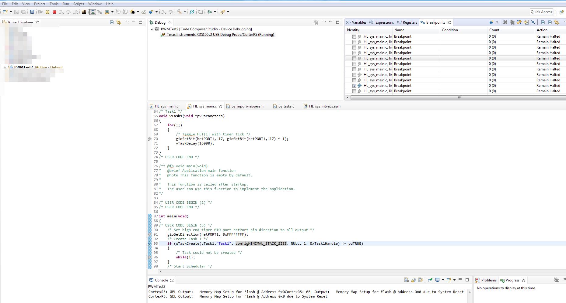

    If I use my VPN connection when I click the debug button, it flashes normally and program stops in the main function, and I have to use the green play button to start my program. So, let's say, i can go step-by-step with my program. However, when I am either offline, or using different network, when my program flashes it no longer stops at the main function, it just runs. Everything related to step-by-step execution or pausing is greyed out. I can only click the red square that stops the execution of the program completely.
    I am using one of the simple CAN Examples in HALCoGen and used two different TMS570LC43 boards. I have not yet tried to use a different PC.
    My assumption is that perhaps during installation of CCS it remembers somewhere the network and maybe there is a constraint there. But otherwise, I have no idea why this happens.
    Tudor
    Can you provide a screenshot of your whole CCS environment when those options are greyed out?
    ki
  • Hello ki,

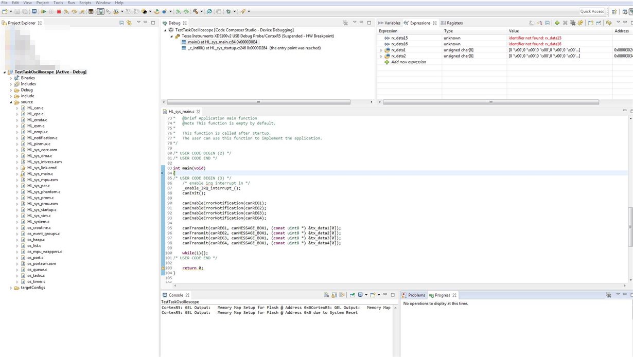

    See below the screenshot. It's just a simple CAN protocol example. I've checked with an oscilloscope, and for sure it flashed correctly and program is working on the board. Just once I hit debug, it flashes and reaches this state. I've also uploaded a picture of CCS when I am connected to my VPN and debugging works properly. The only thing I am doing different is my Internet connection
  • In your second screenshot, a proper debug context is not selected. Note how the top node (Project being debugged)is selected in the Debug view while in your first screenshot, a proper debug context is selected (sub-node underneath). In your second screenshot case, select the node underneath the name of the project being debugged.

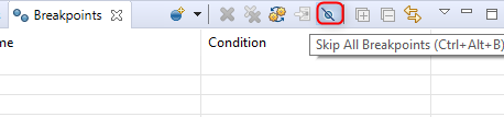

  • I did what you suggested. Now I am able to use reset and pause the program. However, any breakpoint is ignored in my main program. I can set the breakpoints, they are blue, and the program does not stop at them. I tried to reproduce the problem on a different PC, and I could not manage to do it. I will try complete reinstallation of Code Composer.
    You may have enabled the "Skip all breakpoints" option in CCS
    If it is enabled, try disabling it.
    If that is not an issue, please provide a screenshot of your breakpoint sin the source code and in the Breakpoints view
