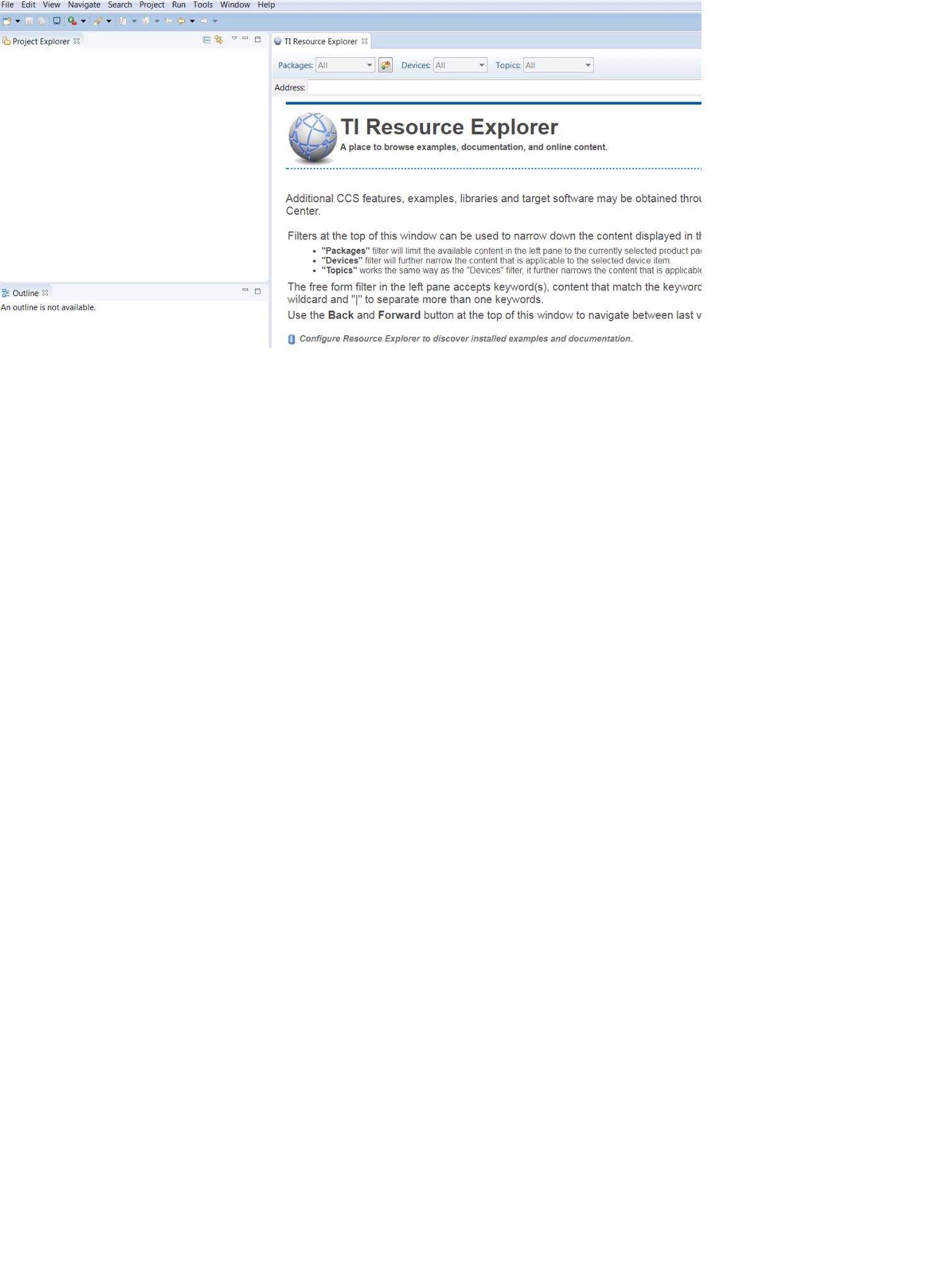

  •  HI John ,
    I m on AM572x  btw .
    what is not working is  :    in View  there is ONLY  resourse explore classis ( not the new  too ) .
    plus in  classic  you see theleft area of the screen of TI resources totally blank  .
    the look for resources button is disable and  I tried to add  , but it did ont work ...
    installation seems to have lost somthing .
    could it be a problem if you install  not in ADMINISTARTOR mdoe ?
    coudl it be the antivirus , any indications ?
    any indication on java machine version needed and how to check ?
    thank you
    regrads
    Carlo
  • Carlo,
    Your environment does not look right at all. There are buttons on the toolbar that we do not include on the toolbar for any of our CCS Edit and CCS Debug perspectives. The menu is also wrong. I see both Navigate and search but we do not show those. It looks a bit like the Analyze Perspective but I am not sure how you would have gotten into that.
    Try going to Window -> Perspective -> Open Perspective -> Other.
    Select the CCS Edit perspective.

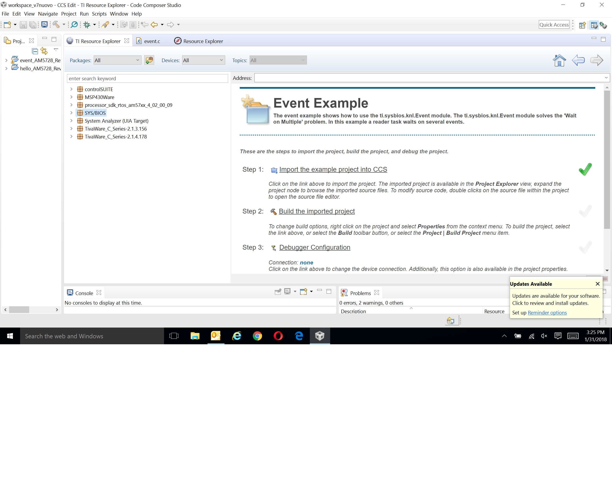

  •   Hi John
    I did some progress  but still a question .
    I reinstalled  CCS  from offline installer as Administrator  and   thinks are better .
    so to recap I m  on AM5728 TIRtos SDK  and latest CCS .
    Now I want to run a  basic HELLO example in TIrtos/Sysbios and following getting started guide in  SDK .
    in Classic explore view  I can see SYSBIOS  while in  Explorer ( not the classic )  I cannot find it ...  where am I wrong ?
    in attach the two screenshots
    regards
    Carlo
  • Carlo,
    You are not missing anything.  The processor SDK (and the sub packages within in it) is not built to work with the new Resource Explorer.
