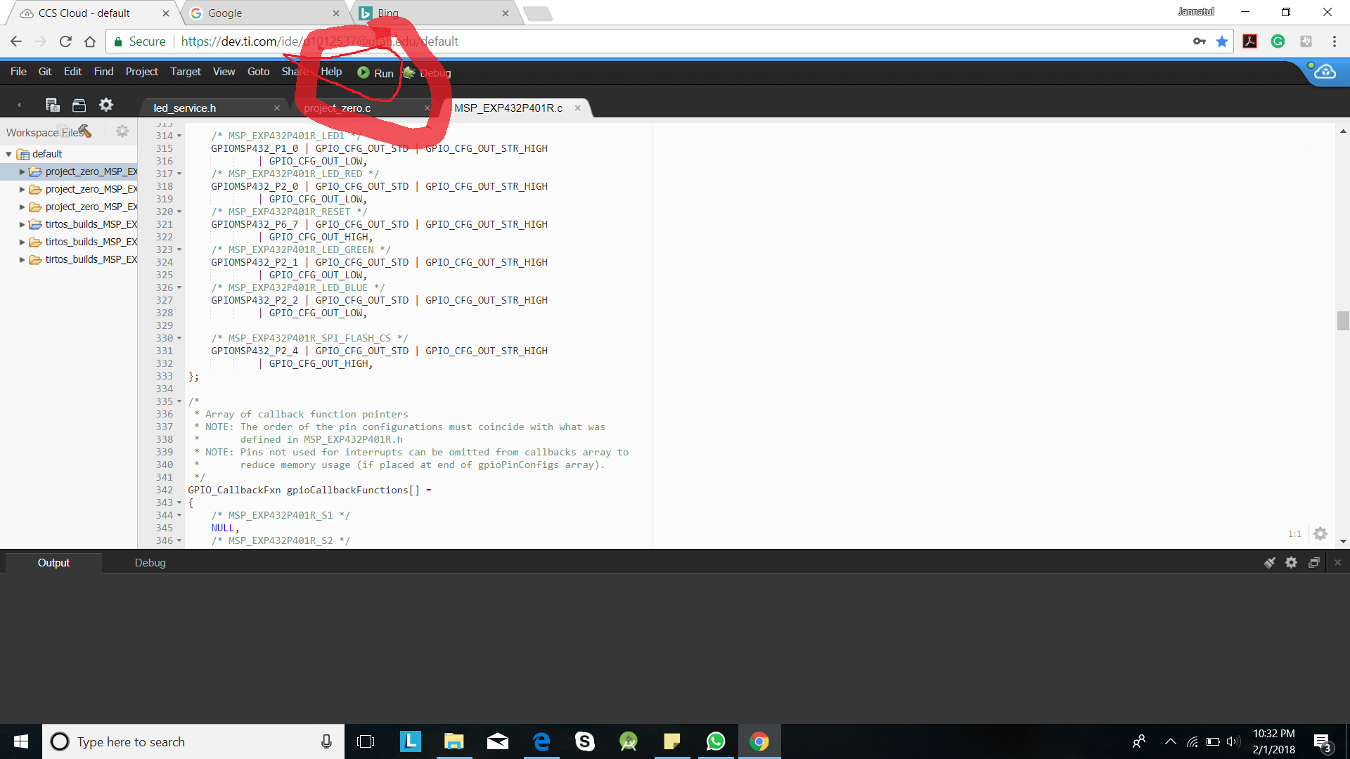

I tried to duplicate project zero by clicking the duplicate button. However, the code for the duplicate could not run. The green button just show grey button. I do not know what to do.
Janna Razali
  • Do you mean that you did a copy/paste of the Project zero project in CCS? Does the copied project build without errors?
    Could you show a screenshot of what the debug perspective looks like when you try to run it?

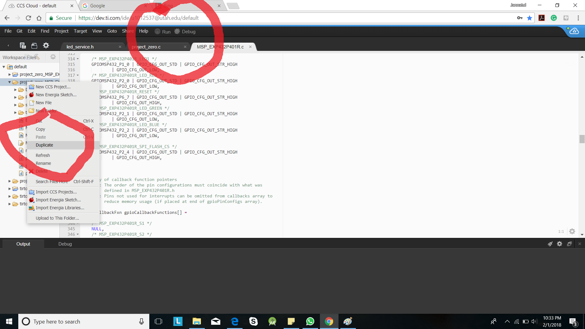

  • code that I duplicate by right click on the original one.
  • Janna,
    It seems that the project you are duplicating is dependent on another kernel project (tirtos_builds_xxx), is that correct? I see the same behavior if I try to duplicate a project that has a dependency on another project. If I duplicate a stand-alone project that has no dependencies there are no issues.
    I think this is an unsupported feature of CCS Cloud. I will check with the experts though and see if this is something we could possibly support in the future. Sorry about the inconvenience but for now you would need to use the desktop CCS to make a copy of these types of projects.
  • I filed this request in our tracking system so it can be considered for a future improvement. The tracking # is TICLD-2529.
