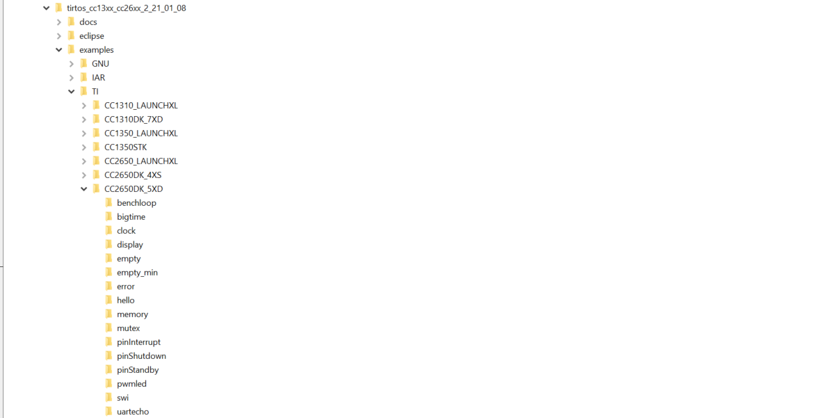

    Did you make the project from scratch?  If yes, can you describe the steps?
    Can you try using out of box projects? Following shows the available examples for 5x5 device.
    You can also try the BLE examples(ex: simple_peripheral and change the board files to BOOSTXL_CC2650MA )
    For more detail regarding changing the board file, you can take a look at our BLE_Software_Developer's_Guide section 6.2 Board File
