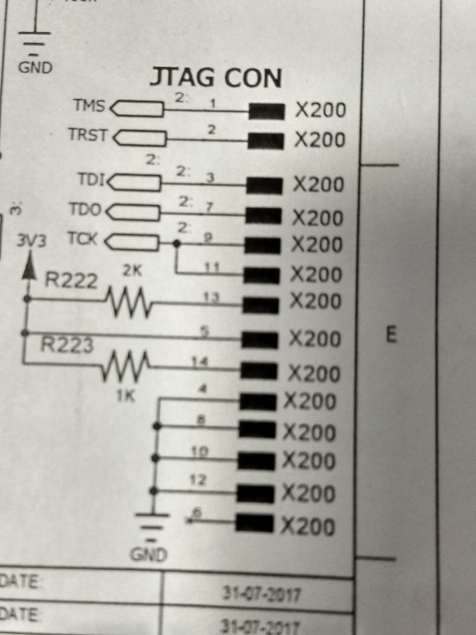

Hello friends,
my hardware is working fine with XDS100v2, but when I am using XDS110 then is not working. When I verify device under Property -> General -> Verify.
XDS 110 is giving below message.

    Thanks for your reply. I had found some discrepancy, I am using same hardware socket for XDS100v2 and XDS110. This seems to be wrong to me.
    Does both JTAG devices is having different connection pin outs.
    I will check and update. if you have any information on this the please share links.
    thanks
    Yogesh

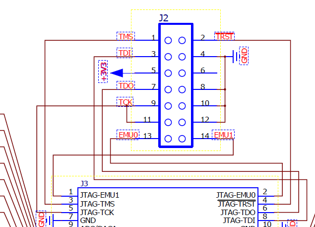

  • Hello Mr. Rafael,
    I got XDS110 working, but now XDS100v2 stops. Actually earlier I was few registers in JTAG connection (as shown in JTAG CON image) and that we working well for XDS100v2. For XDS110 we have to do connection as per J2 connector below circuit shown.
