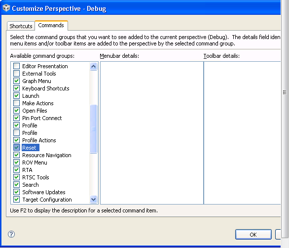

    1. I selected "Enable silicon real-time mode" in the generic debugger options per your instruction, but I still cannot find the button for real-time mode toggling as in the C2000 video. What should I do to enable it?

  • Zheng,
    If the buttons are not showing up you can add them.  Right click in the toolbar area and select "Customize Perspective".  There is also a menu item on the Window menu.  Click on the Commands tab and check the box for Real Time.
    There is debug IP in the device itself that enables real-time mode.
    John
  • Anonymous
    0 Anonymous in reply to JohnS
    Dear John,
    I followed the steps but was unable to find "Real Time" in the options. Why is that? How can I enable the option?
    Zheng
  • Zheng,
    You are probably using an older version of CCS. That toolbar was added in a later version. Try updating your version of CCS.
