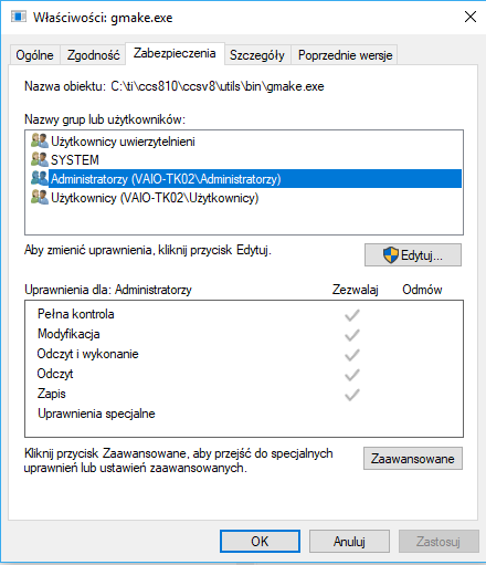

  • Hi All,
    I am not a Win10 specialist nor MS Windows fan.
    In my modest opinion CCS and all other program packages should be installed with an admin privileges.
    To do that you need:
    right click on ccs_setup_8.1.xyz
    and select "Run as an Administrator".
    Could you check the properties of gmake.exe in this terrible installation.
    In my case path is c:\ti\ccs810\ccsv8\utils\bin\gmake.exe
    Unfortunately I am using a Polish version of Win10 however I hope the picture below would help you to setup
    the access properties for other users.
  • Mitchell said:
    We seem to have narrowed down the problem to an issue around Windows hiding or blocking the ability to run "gmake.exe". This looks to be related to Windows 10's security features, which we are unable to disable without administrator privileges.
    We have heard of issues in the past where an anti-virus, security software or Windows firewall prevents access to gmake and causes these types of problems. Please see this link.
    The solution is to temporarily disable the offending software or to try whitelisting CCS and its build utilities.
