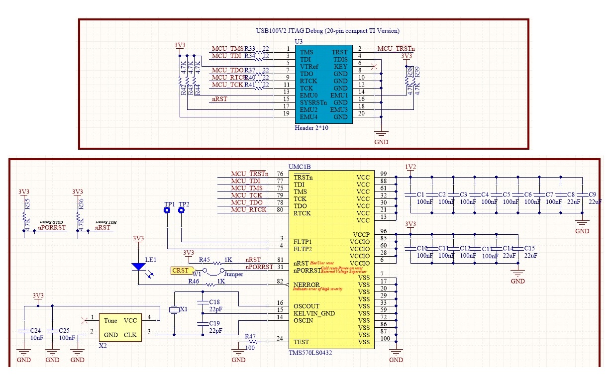

I'm using "TMS570LS0432" and CCS ver.6.0.1 to developing a project and my programmer is "USB100v2", provided by "blackhawk"
My board contains two same Micro with same schematic and same software. I could programmed both of chips without any problem but after a while one of them wasn't programmed any more and the CCS showed me an error below:
Error connecting to the target: (Error -241 @ 0x0)
A router subpath could not be accessed.
A security error has probably occurred.
Make sure your device is unlocked. (Emulation package 8.0.27.9)
Even I tried to program and erase the chip with "UniFlash" but it showed me the same error.
I replaced my chip with new one and it worked fine for a while but the problem has been occurred again.
The USB100v2 has been connected to the chip with following schematic:
I have spent many hours.
please help
  • Hello Ashkan,
    Do you use one JTAG header (JTAG daisy-chain) for both MCU devices on your board?
    Is the nERROR signal turned on on your un-connected MCU? The schematics look ok to me.
  • Thanks for your reply
    Actually I have two completely separated microcontrollers with two independent JTAG header.
    and the nERROR signal is always off.
    The weird thing is that, I had programmed both microcontroller before one of them got problematic. I changed the defected micro with a new one and it worked fine for a while, but after a few times of programming it has gotten problematic too.
    It really makes me confused.
  • Hello Ashkan,
    It looks like the board issue. I noticed that you connect 2 clock sources to MCU:
    1. crystal X1
    2. crystal X2
    If the MCU doesn't have a valid clock, it will not be able to work properly.
