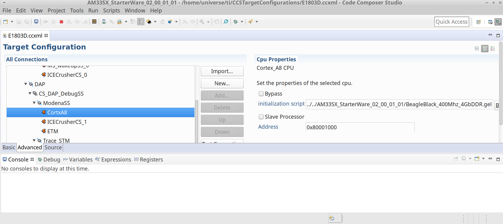

    Let me see if I understand this correctly; the application runs fine if it starts and runs by itself with no debug session, booing from a SD card or other external source but, if you load the code via CCS and put the device to run, it fails to complete execution. Is that correct?
    If that is the case, I would definitely double-check the boundary conditions for this to happen, such as the execution of GEL scripts (which are not present if the device runs by itself) or the executable itself (it may be different between the two methods - I have done that).
    qxc said:
    Or alternatively: is there a possibility to start the application normally and without the debug probe and later attach to the running process to see what it's current state is?
    Certainly. That may certainly help either uncover differences between the two methods of runtime. Check:
    http://software-dl.ti.com/ccs/esd/documents/users_guide/ccs_debug-main.html#manual-launch
    Hope this helps,
    Rafael

  • I tried to follow the description in given link but do not see a "Connect" option. Please refer to the image below: when I right-click CortxA8, a popup-menu opens but it does not contain this option:
