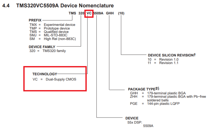

  • Hi Paolo,
    As you can see in the images below, this part of the name of a TI's DSP is the technology of manufacturing and this does not affect the CCXML file. You can easily choose TMS320C5509A instead of TMS320VC5509A and make your CCXML file.
