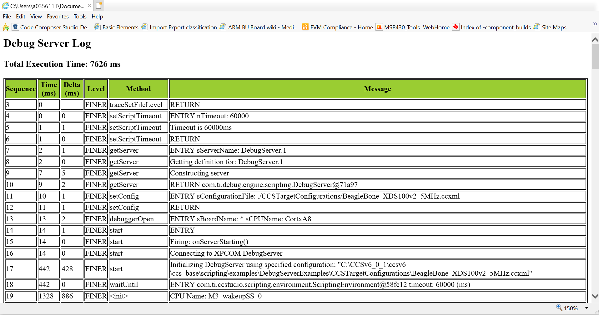

    Please apologize for the delay.
    user5233338 said:
    -Is the memory access (from the computer) halting the processor? The script is supposed to collect data from a F28335 controlCARD that will be controlling an inverter for a solar panel so, since it should be servicing interrupts, we do not want anything to go wrong.
    As I mentioned in my previous post, any memory accesses will halt the CPU, thus potentially disrupting interrupt requests unless you use Real-time mode.
    user5233338 said:
    -Is there a way to get the computer time and append it to the file we are writing? All the functions that I found in your API to write files takes an address from the target memory to read data from there. I thought about using periodic interrupts in the F28335 and to count them in order to track the time but I think it would be better to directly use the computer time.
    The DSS log has timestamps starting from the beginning of the execution of the script, which will be written to the file <Flash28M35Log.xml>. This file will be nicely formatted if you also have the file <DefaultStylesheet.xsl> in the same directory. Something similar to what is shown below:
    Hope this helps,
