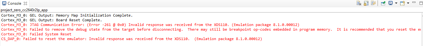

The connection to the launchpad fails when running the project host_test
The error msg below is shown.

  • Les,
    Given the launchpad used to work previously on this laptop (I assume with prior versions of CCS), I suspect you may be running into the issue I mention on this e2e thread
    e2e post said:
    But before doing that, I would like to cover one important detail that I learned today from the development team that did the newer XDS110 emulation package software (emupack).
    The emupack that ships with CCSv9.0.x versions (8.1.0.00012) has some jitter on the clock edges when running at 2.5MHz (the maximum speed of this version(, which may cause very random communication errors with the target. Although errors are not regularly seen with the compact Launchpads, the longer cconnections of your setup (or even the use of isolation adapters, for example) can contribute to this problem.
    The remedy for this is to lower the TCK speed to 1.25MHz. This will reduce the jitter and should warrant a reliable connection.
    This issue will be fixed in the next release of the emupack, to be available publicly soon.
    Please let me know if the workaround helps you.
    Rafael

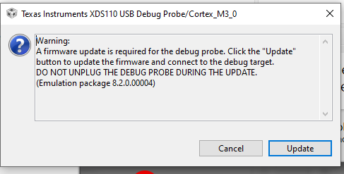

    When CCS loads debug probe the same message as previously displays. It promted for an XDS firmware upgrade but displayed msg - cannot connect when upgrade was attempted.

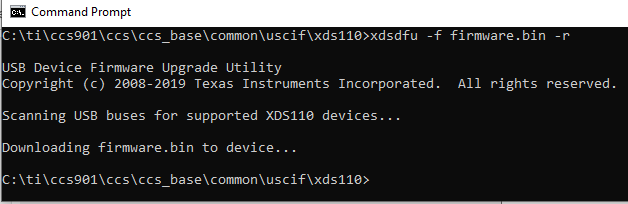

    I tried to load firmware using XDSDFU utility -  the firmware.bin file only has a date stamp of  03/06/2019 (3 June 2019)

  • Les,
    Please apologize for the delay; I couldn't reproduce the scenario here on my environment, but I recalled the thread below, which does not help much given this error is quite elusive and without a clear root cause.
    https://e2e.ti.com/support/tools/ccs/f/81/t/737649
    I tested both CCSv9.0.1 (with emupack 8.1.0.00012) and CCSv9.1.0 (with emupack 8.2.0.00004) but the problem did not show itself.
    One important aspect when updating the firmware is that, due to a bug on the Dialog box, it stays open even after you click ont he "Update" button. If you click a second time, the probe gets disconnected and the firmware update process fails.
    Re-launching the debugger or fully power cycling the board (disconnect/re-connect teh USB cable) seems to restore the previous condition with the updated firmware.
    The method you are using in your last post (via the xdsdfu utility) is the safest one.
    http://software-dl.ti.com/ccs/esd/documents/xdsdebugprobes/emu_xds110.html#updating-the-xds110-firmware
    This behaviour will be fixed in a future release of our tools.
    Rafael

    I managed to reload the firmware by downloading the bootloader as per 'recovering a bricked Launchpad' information.
    For the moment all is working fine.
