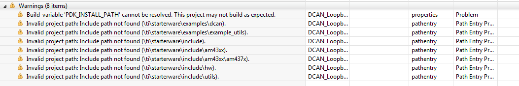

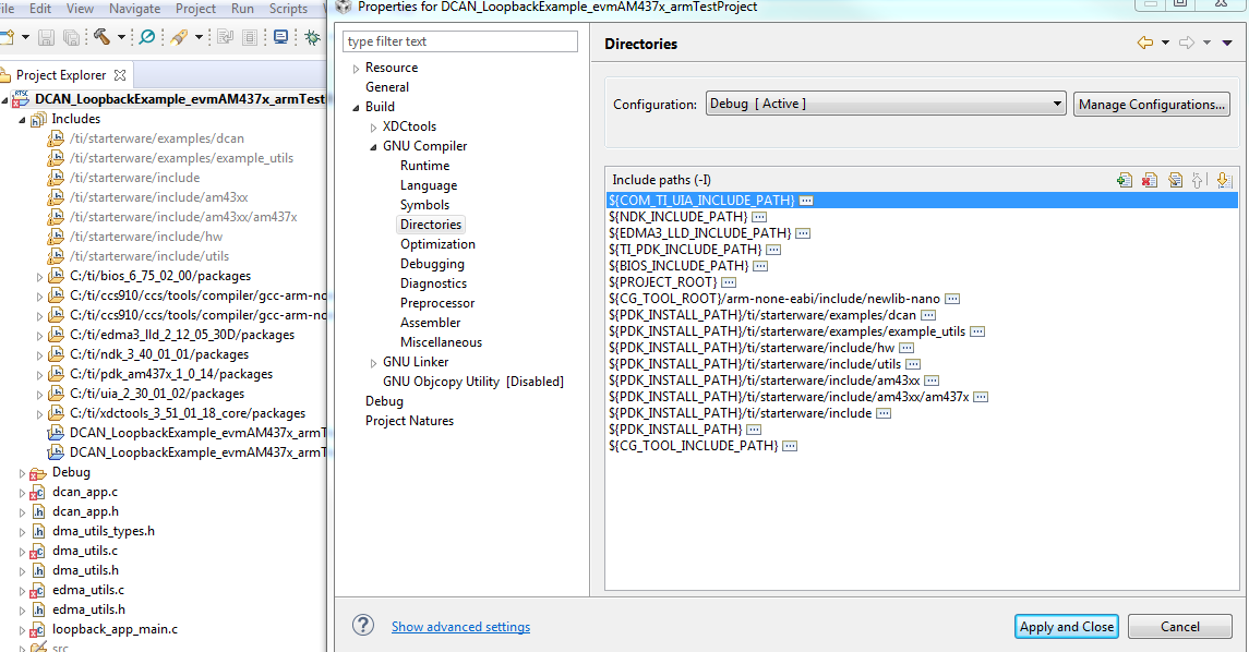

When I import the project, a few of the "Includes" paths can not be found. I also receive a warning that the build-varaiable PDK_INSTALL_PATH can not be resolved. All the missing paths are also linked to this variable, as you can see from the following screenshots (Project->Properties->build->GNU Compiler->Directories):
 The warnings can be seen below:
When I edit the missing paths to be C:\ti\pdk_am437x_1_0_14\packages\ti\starterware\examples\dcan instead of linking it to the PDK_INSTALL_PATH variable, all warnings disappear. However when building the project, I receive the error that there is an undefined referenence to __kill. You can refer to the build log below:

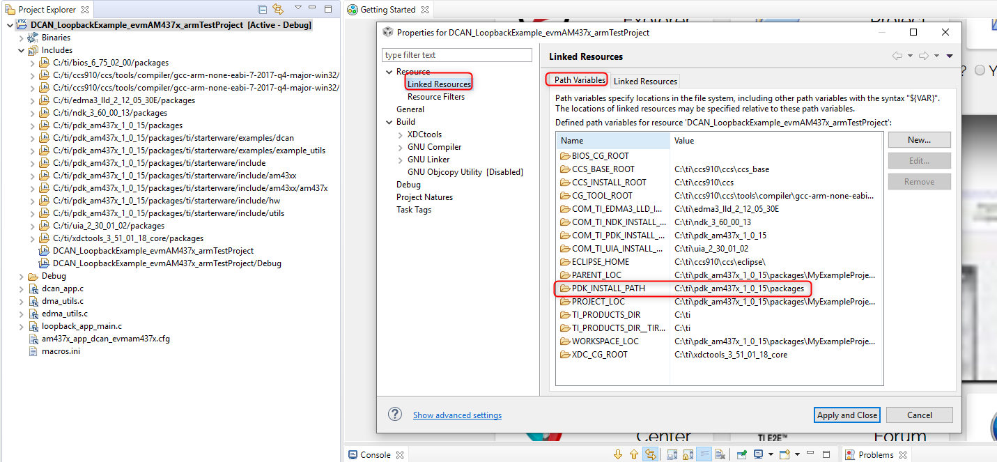

    The generated project is designed to use the PDK_INSTALL_PATH variable. I would add that variable to the project, as a Linked Resource Path Variable, and set it to the correct path.
    Example:
    This should properly set up all the paths of the project and you should be able to build it successfully (worked for me)
