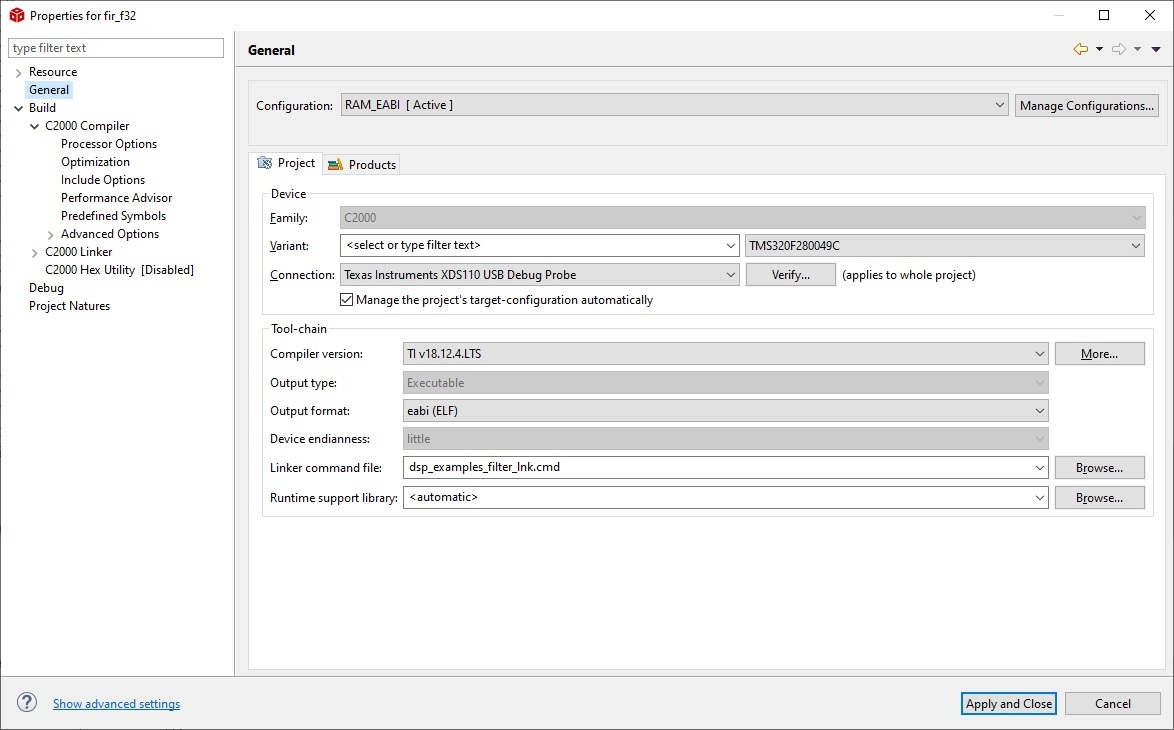

I bought the LAUNCHXL-F280049C launchpad and opened the fir_f32 example project.  The project compiles fine, but when I click "Debug" I get the error shown below.
Error connecting to the target:
(Error -151 @ 0x0)
One of the FTDI driver functions used during the connect
returned bad status or an error. The cause may be one or
more of: no XDS100 is plugged in, invalid XDS100 serial number,
blank XDS100 EEPROM, missing FTDI drivers, faulty USB cable.
Use the xds100serial command-line utility in the 'common/uscif'
folder to verify the XDS100 can be located.
(Emulation package 8.3.0.00003)
I haven't changed any jumper settings on the board from default and the board powers up and blinks leds with whatever default application is loaded.  I downloaded the latest CCS so I'm running version Version: 9.2.0.00013 .  During instillation I chose full install so I should have the drivers etc...  I've attached two screen shots as well showing my project configuration and the XDS ports in device manager.  I've also attached a screenshot of the error message.
Does anyone have any idea what might be going on or where I should look next??

  • Hi Robbie,
    Please see:
    Section A1 FAQ 3d (page 25) of: http://www.ti.com/lit/ug/spruii7a/spruii7a.pdf
    And also: https://www.youtube.com/watch?v=4ZoXwM3-Szw&feature=youtu.be
    ki

  • Robbie Valentine86 said:
    Unfortunately this hasn't allowed me to connect to the target via debug - I still have the same error message.
    Which error message? If you mean:
    (Error -151 @ 0x0)
    The above error is a failure when attempting to communicate with an XDS100 debug probe. The launchpad has an integrated XDS110 probe instead. I don't know why an error message for the XDS100 appears. Make sure you are using the correct target configuration file when launching a debug session.
    ki
  • Sorry Ki - your recommendation fixed it.
    For anyone else - check to make sure that the debug configuration is using the correct target config / ccxml file.  That was where I went wrong.  I hadn't realized my debug configuration pointed to the wrong one.
    Thanks Ki!!
  • Great to hear it is all working now. Thanks for the update!
