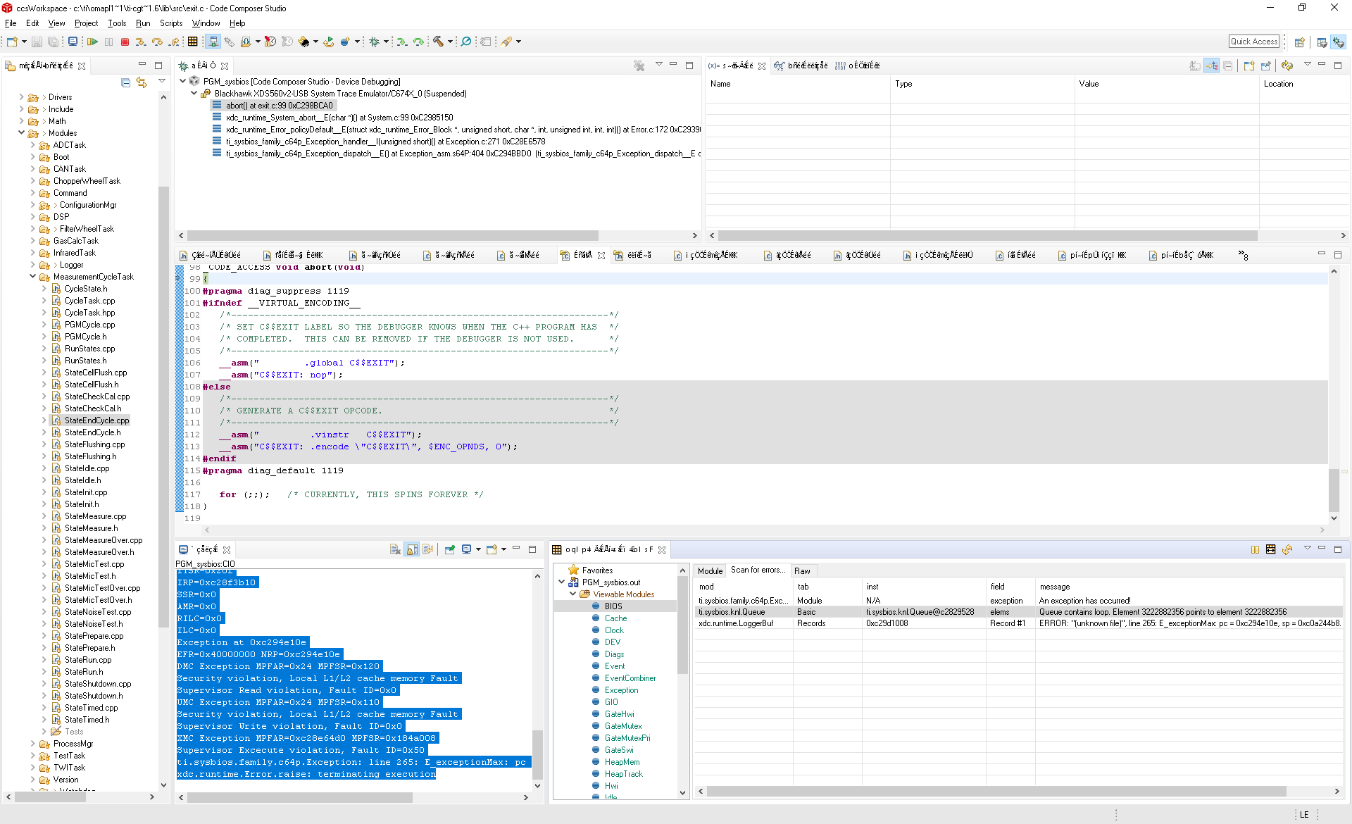

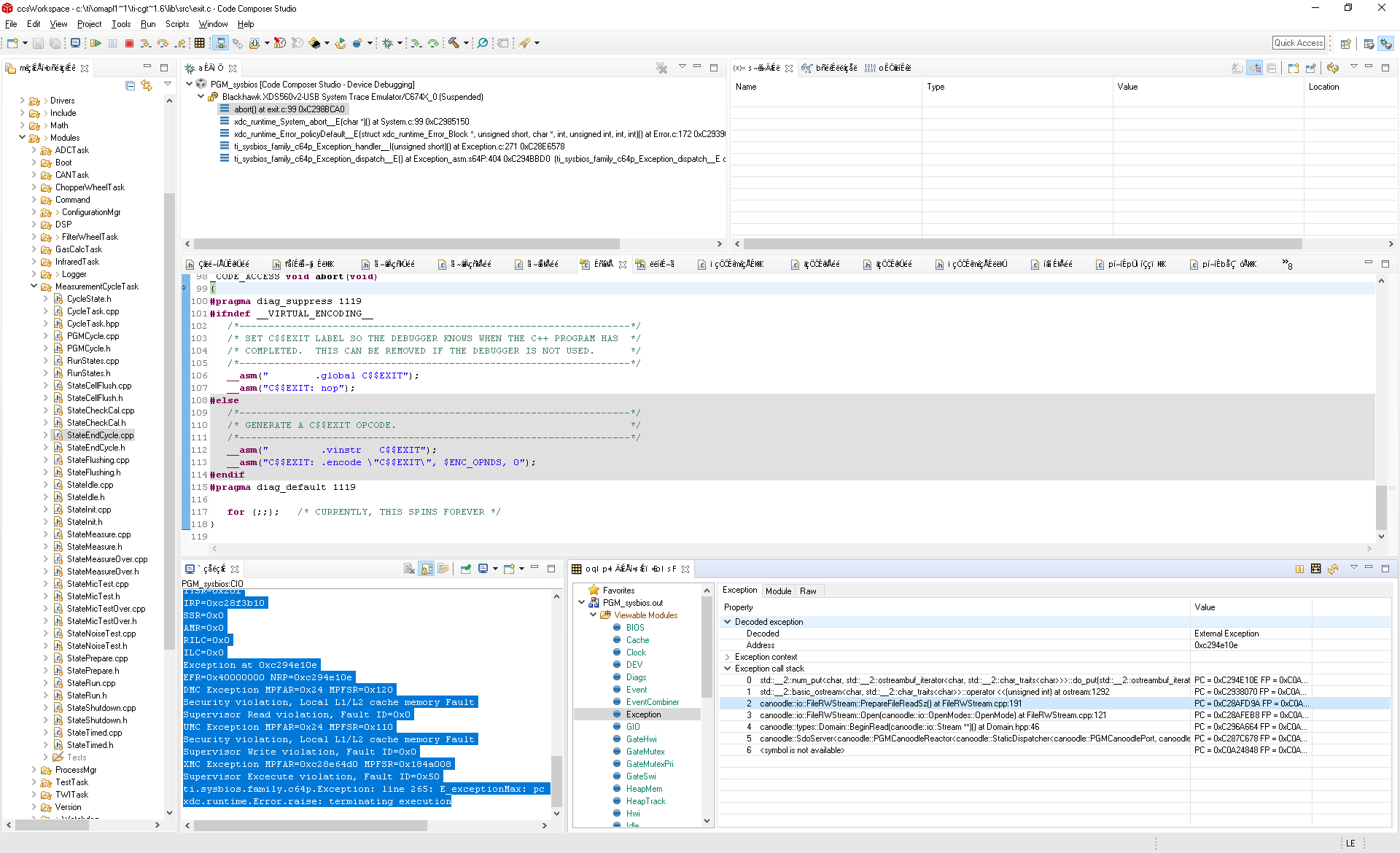

I was looking with ROV and Exception module returns these:
Exception call stack,
0 ti_sysbios_heaps_HeapTrack_free__F(struct ti_sysbios_heaps_HeapTrack_Object *, void *, unsigned int) at HeapTrack.c:145,PC = 0xC2924C1C FP = 0xC0A1CE68
1 xdc_runtime_Memory_free__F(struct xdc_runtime_IHeap___Object *, void *, unsigned int) at Memory.c:90,PC = 0xC2987F78 FP = 0xC0A1CE90
2 [local to vla_alloc_c]::free_dead_allocations(void *) at vla_alloc.c:177,PC = 0xC294EEE8 FP = 0xC0A1CE98
3 __vla_alloc(void *) at vla_alloc.c:245,PC = 0xC2913140 FP = 0xC0A1CEB8
4 std::__2::num_put<char, std::__2::ostreambuf_iterator<char, std::__2::char_traits<char>>>::do_put(std::__2::ostreambuf_iterator<char, std::__2::char_traits<char>>, std::__2::ios_base &, char, unsigned long) const(unsigned int) at locale:1514,PC = 0xC294C014 FP = 0xC0A1CEE0
5 std::__2::basic_ostream<char, std::__2::char_traits<char>>::operator <<(unsigned short) at ostream:1292,PC = 0xC2933CF0 FP = 0xC0A1CF28
Apparently ROV reports on BIOS module: "All ROV views have been run and no errors were encountered. In BIOS, this includes a check of the System stack usage and all Task stacks."

  • Hi Todd,
    I followed the instructions in TIRTOS_CCSDebugging.pdf, enabled HeapTrack which says I have 1564 objects, is there a quick way to see which one is overflowing or do I have to check manually each one? This is the latest error:

    Any suggestions are welcomed.
    David.
  • I tried debugging these exceptions and seem to be happening around std::ostringstream, the code does in various threads:
    std::ostringstream *p = new std::ostringstream;
    (*p) << "some random length text";
    This p is passed to one central thread using a mailbox for logging that calls:
    std::cout << p->str() << std::endl;
    delete p;
    Seems that when using 8.3.6 compiler the mailbox sometimes pends an incorrect message resulting in exceptions above.
