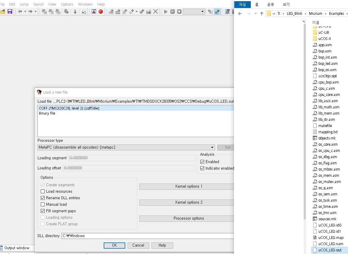

    When I build the source code of the existing LED BLINK project, .out file is created.
    When the file is opened with IDA analysis tool, it is recognized as a COFF file as shown below.

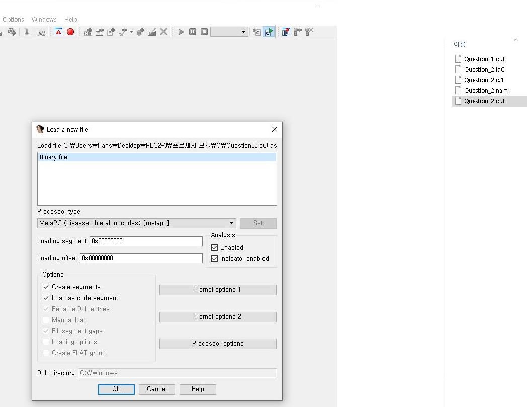

    However, .out files using the memory save utility are recognized only as binary files.
    I'm not sure if this makes a big difference, but the LED BLINK works on the TMS320F28335 board and has the source code.
    The .out file I provided to you was created using the memory save utility.
    It does not have the source code, and it uses the JTAG simulator to extract the memory area of the 320C6748 module.
    I don't know much about the IDA tool. However, TI's ofd tool recognizes both *.out files generated from the memory save tool as COFF:

    Note that a *.out file generated by the compiler would have additional symbolic information needed by the debugger for debug visibility. Perhaps the IDA tool is looking for that information. The information in the COFF file generated from the memory save utility has only minimal information. It really is just a basic memory dump in the COFF file format.
