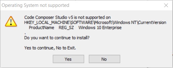

  • Thanks for the answer John. Yes I downloaded the Version 5.1.0.09000. but it seems not compatible with Windows 10, it gave an error at installation stage. Maybe I should find another pc with win 7
  • What was the error that you got at install time?  Did it allow you to proceed.  There is a good chance that the installer is checking for compatible windows versions.  It likely doesn't recognize Windows 10 as that CCS came out way before windows 10. I thought we just wanted you though and allowed you to proceed.
    Talking to one of my colleagues he has not had issues on windows 10 with his v5 installs.  I am on mac so I can't try this.
    John
  • Here is the error message when I want to install the v5 to my win10 Pro. I can continue to installation but I think the installation is not completed as it should be.
