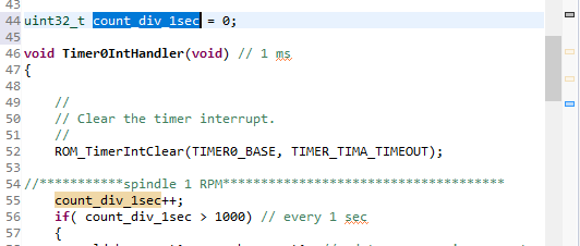

In version 9 and earlier of CCS, highlighting a variable name typically resulted in all instances of that variable being highlighted in a light grey and showed little boxes on the right side of the scrollbar to quickly jump to other references of the variable when clicked.  In 10.1.1.00004 this no longer happens.

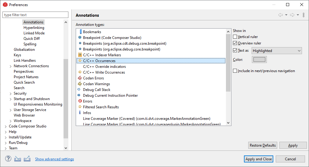

    Under Window -> Preferences -> C/C++ -> Editor -> Mark Occurrences is the "Mark occurrences of the selected element in the current file" selected?
     You need to select Show advanced settings to get the C/C++ preferences displayed.

  • I uninstalled, reinstalled, and now it's partially working.  It highlights one instance, but not the one right under it?  Settings are still fine
    It looks like it has highlighted the write occurrence, but not the read occurrence. In the CCS preferences there are there are two types of Annotations for these, shown from a working installation:
    If your CCS preferences match the above, the issue might be with the indexer.
    In which case, does Rebuild Index help?
  • My annotation settings are the same as yours it seems.  I tried rebuilding the index and nothing changed.  I unchecked all the boxes, clicked apply, rechecked the boxes, hit apply again, and then rebuilt the index again after that.  Still not working strangely.  There's another write occurrence later on in this function and that one is not being highlighted.  I also closed and re-opened CCS after the last time I rebuilt the index to see if that helps, but that didn't make a difference.
