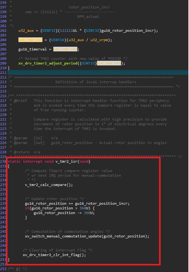

I have an issue, if I have any interrupt handler in my code (example of one can be seen bellow) the code of this function is not highlighted at all, but I want it to be highlighted as the rest of the code. Also if I choose any global modules variable or function call in IRQ handler, CCS do not highlights this global module variable / function call as it highlights in the rest of the code. Can anybody please help me to solve this problem? Its really uncomfortable for me :)

  • The issue is related to the "static interrupt" keywords of the function. There is an older related thread describing a similar issue here.
    If you change the function to "interrupt static" the syntax coloring should work ok. Hope this helps!
