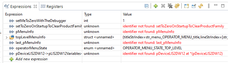

    I hid Expressions by switching that pane to the Registers tab; it ran continuously. While it was running, I switched back to the Expressions tab; it hit a phantom breakpoint almost immediately. This was repeatable. So it seems that showing the Expressions tab is what makes it stop at phantom breakpoints. My Expressions tab looks like this:
    I started removing the expressions one at a time, starting at the end, checking to see if it still stopped at phantom breakpoints after removing each one:
    • pDeviceLIS2DW12->pLIS2DW12Variables->acceleration_X
    • operatorMenuState
    • last_pMenuInfo
    Removing last_pMenuInfo enabled it to run continuously. I added it back; it still runs continuously. I added the others back and it runs continuously. I rearranged my browser tabs back to how they were originally and it runs continuously. I stopped and restarted the debug session, exited and restarted CCS; nothing I have found makes the problem come back. So it seems like deleting and recreating the expression for last_pMenuInfo fixed the problem.
