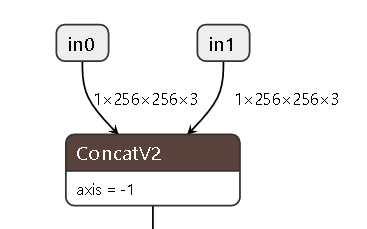

i am importing a cnn , i have to fill tidl_import_test.txt , this cnn has 2 inputs (in0 and in1 from img1.bmp img2.bmp )
how can i configure in tidl_import_test.txt. ?
Thanks!

Input layer properties of multiple inputs can be specified like below
Import config file
modelType = 2
inputNetFile = "../../test/testvecs/models/internal/onnx/tiad_motion_semantic_image_rawdof_rgb/models/pixel2pixel_model.onnx"
outputNetFile = "../../test/testvecs/config/tidl_models/onnx/tidl_net_onnx_tiad_jmodSegNet.bin"
outputParamsFile = "../../test/testvecs/config/tidl_models/onnx/tidl_io_onnx_tiad_jmodSegNet_"
inElementType = 0 0
inQuantFactor = 1.0 1.0
inWidth = 768 768
inHeight = 384 384
inNumChannels = 3 3
inData = "../../test/testvecs/config/segmentation_mod.txt"
Refer below for listing input BMP files
ti_dl\test\testvecs\config\segmentation_mod.txt
