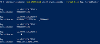

    I'll try setting the environment variable shortly to get the more detailed log, and I'll post it here.
    I'm also not using a proxy.

  • Hi Cory,
    I also got the following request to pass on to you.
    run the following command in Windows Powershell(admin mode) and share the output
    Get-WMIObject win32_physicalmedia | Format-List Tag, SerialNumber
    David

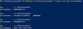

  • Hi David,
    I figured out the issue with this command.  I had a microcontroller eval board with an onboard programmer plugged into my computer.  When I run the command with that plugged in, I see the drive with the unicode Serial Number:
    If I unplug the board and run it again, it disappears:
    I must have had it disconnected when I got the installation to work.
    Thank you for the help!
