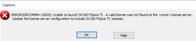

I'm trying to install PSPICE for TI and the installer hangs at or near the final step.  I closed the installer, rebooted the machine, and invoked PSPICE for TI but I get this message:
ERROR(ORCOMMN-12005): Unable to launch OrCAD PSpice TI. A valid License was not found at the <none> license server. Update the license server configuration to include OrCAD PSpice TI licenses.
I've reviewed other postings:
https://e2e.ti.com/support/tools/simulation-hardware-system-design-tools-group/sim-hw-system-design/f/simulation-hardware-system-design-tools-forum/1162385/installation-issue
and
https://e2e.ti.com/support/tools/simulation-hardware-system-design-tools-group/sim-hw-system-design/f/simulation-hardware-system-design-tools-forum/1018327/pspice-for-ti-installation-doesn-t-complete
I installed it without elevation, just for my username, and there are no other OrCAD or Cadence products installed.
The license file located here, is empty (a 0-byte file):
c:\Users\<user>\AppData\Roaming\Cadence\VBL\TI_PSpice_231\license\license.txt
I assume it was unable to download the license file.  How do I get the license file?
