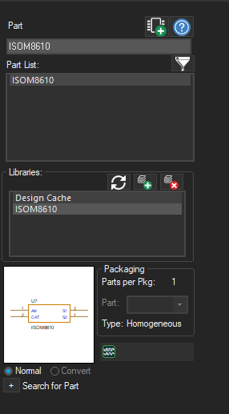

Hello Andrew,
I am receiving a WARNING(ORCAP-2445): Instance U2: Schematic1, Page1, not found in the configured libraries. U2 is the ISOM8110. Can you point me in the right direction?
Thanks!
Thank you for your question.
Please give us an additional 24 hours to answer your questions.
Aaditya Vittal
Hello Roger,
The library file and symbol should show up on the libraries list as shown in step 5. Are you seeing the part show up in the library dialogue?
