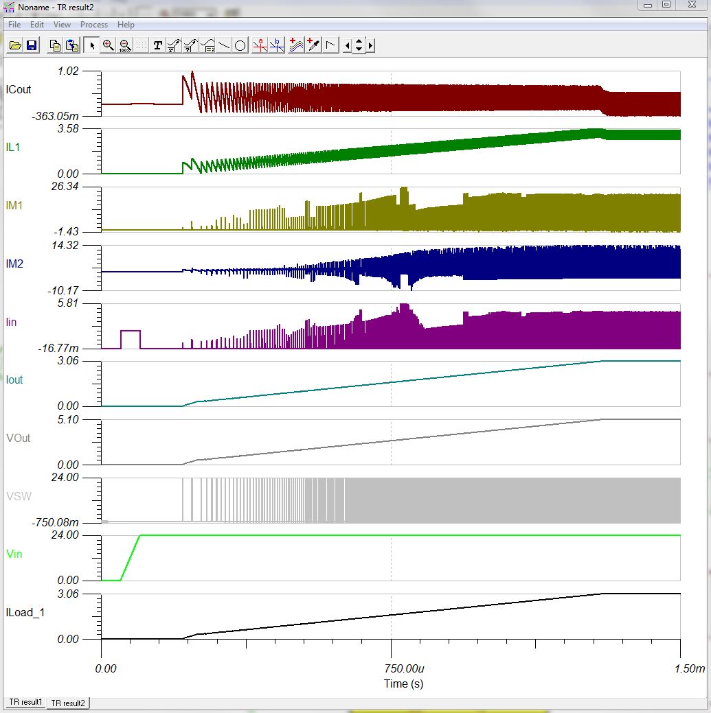

I exported the file attached and it is not functioning.
 2402.webench_design_1191697.tsc
  • When Run by TINA, the Power Supply should provide 24V. There is no output from it. I tried to use another Voltage source, the DC or AC gives me error. I tried to fix the error but failed.

    According to your spec your input voltage to the power supply is Vin: 23- 25V, your output voltage is 5V and output current is 3A. I import the TINA file and run the transient analysis for startup and it seems to show the expected result.
    Do you expect a different output voltage for this power supply?

  • Hi Salah,
    Since the circuit is export for startup simulation so it required to run sometime before it can settle down to a stable output voltage. I think you can try the "Analysis --> Steady Stage Solver" and run the the default value, it will solve all the node and show the voltage and current when the circuit reach steady stage.

  • The exported .TSC file is functioning correctly. The simulation that was exported is a transient simulation with a transient model. The simulation runs properly if you select Analysis--> Transient you will get the simulation that was requested and exported.
    You cannot use the DC analysis on a transient IC model. It will not provide any useful information.
    I do not recommend using the Steady State solver either. The transient simulation will provide all of the same information once the simulation is complete. The simulation takes less than a minute to run and provides all of the necessary waveforms to evaluate the design.
    The proper way to view the circuit voltages and currents with a transient model is to run a transient analysis. You can look at the values at any specific time point you wish, however, you must run the simulation first. It is a time based simulation.

    LM3150 belongs to a type of voltage regulators called switched-mode power supplies. The idea is to deliver power in chunks using a switch, in-between these chunks, an energy storing component (inductor or capacitor) will keep the current flowing through the load.
    Due to this nature, you can think of an SMPS as having 2 DC operating points, 1 with the switch turned on and 1 with the switch turned off. If you run a DC analysis, you will get 1 of them.
    The other thing to remember is that in this exported design, the input voltage is 0 at time=0. It starts to rise at 50us and reaches 24V at 100us. You DC analysis won't know any of this. It would just take the value at time=0, which is 0. Hence all the nodes in the circuit are practically at 0 per the DC analysis.
