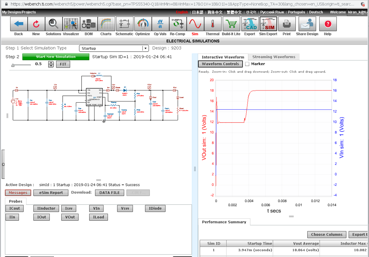

I am in the process of selecting the buck converter for my application. I could find the above mentioned part with my requirements and also i could simulate the same in WebBench tool.
Then i wanted to play around a bit so i exported the model to Tina as .tsc file. Unfortunately the model does not show the behaviour as it is showing in WebBench.
Could you please check the same. I have attached the .tsc file here. Please check.

Hi Durgaprasad,
For the spec(Vin : 8 - 17 ; Vout : 18 ; Iout : 1) , We ran TPS55340-Q1 on webench and also exported to tina and compared the results where the behaviour of Tina results are almost same as Webench.
Please find the Webench and Tina results below:
Webench results:
Tina results:
Also i tried running your attached tina .tsc file which is running fine for me which is similar to above shown results.
Could you please confirm if your tina results are different from the above shown Tina results?
