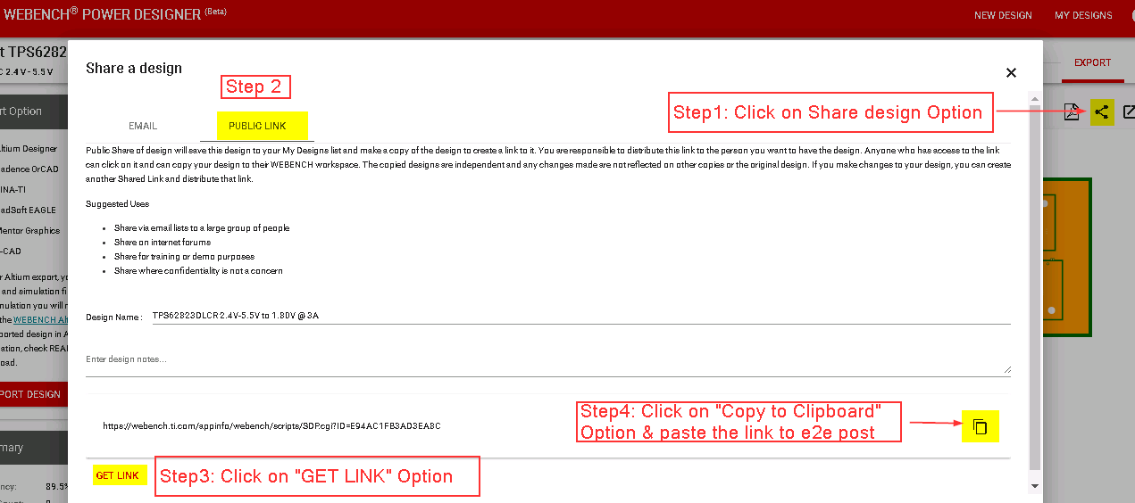

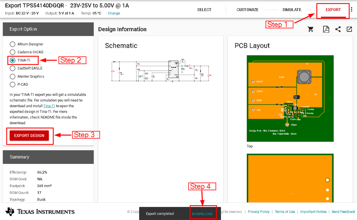

Thanks for sharing the design. I exported the shared WEBENCH design to TINA-TI and the exports worked fine for me.
I followed below steps for exporting the design to TINA-TI.
Also, please find below TINA-TI (.tsc) exported file FYR. Kindly let us know if you are still facing the issue. Also let us know the version of TINA-TI that you are using.

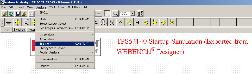

To run transient analysis, Go to Analysis -> Transient and then click on Ok to run with default settings.
