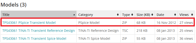

Our customer are looking for the PSPICE model for LT SPICE.
According to the following E2E, The PSpice model on the web is encrypted and will only run in PSpice 15.7 and up.
https://e2e.ti.com/support/development_tools/webench_design_center/f/234/t/358723#pi239031349filter=all&pi239031349scroll=false
So, can we not use the PSpice model of TPS43061 on the web for LT SPICE?
If yes, could you please send us it, if you have the PSpice model for LT SPICE?
I’m understanding that there is TINA-TI Spice model.
However, they would like to use LT SPICE.
I’d greatly appreciate your verification.

  • Hello Kanemaru,
    We have an new and easy process for the TI field to access unencrypted models. Can you please ask your TI contact to send me an email and I can send this information to them directly.
    Also, note that we can only provide the unencrypted models but can not guarantee the working in simulators other than PSpice and TINA-TI as each simulator has its own syntax and limited extent of PSpice compatibility.

  • Hi Nikhil-san,
    Thank you for your prompt reply!
    They have already simulated their circuit on LT SPICE.
    Therefore, they would like to need the PSPICE model.
    If you contact to below my e-mail address.
    I’m looking forward to hearing from you.

  • Hello Kanemaru-san,
    I have sent you an email regarding this. I will be closing this post and continue our correspondence through email.
