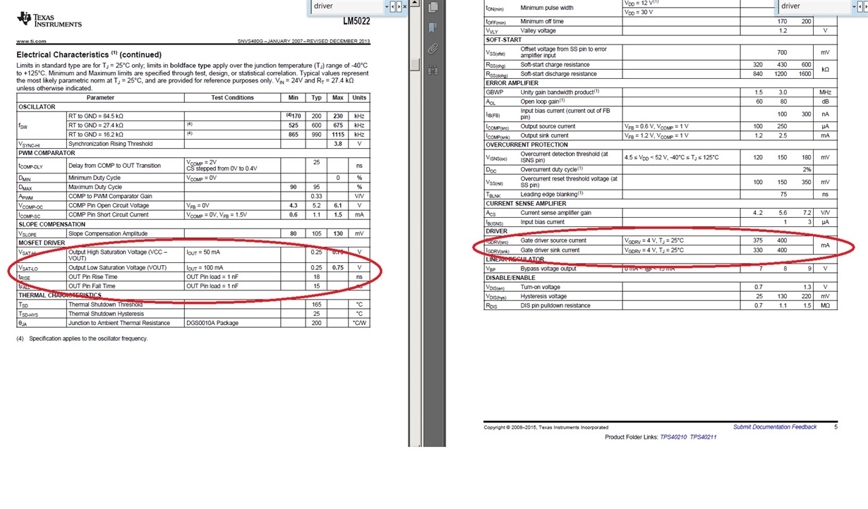

    1. Could you give an advice for driver current for LM5022 and TPS40210. Looking in to datasheets I try to compare drive currents. Please see below.
    The table for LM5022 contains Vsathi and Vsatlo at the test conditions 50mA and 100mA respectively. It is not maximum drive current. Suggesting datasheets peak current is 1A for LM5022. Please see below.
    Driver current is 400mA for TPS40210. But it is not noted that is current average, RMS or peak. Is TPS40210 capable to drive peak current up to 10A? Could you give more accurate definition of currents for both chips?
    2) WEBENCH successfully performs simulation with TPS40210 at oscillation frequency up to 500 kHz. Temperature of FET is 78C, power dissipation of the FET is 0.5W, total efficiency = 64%. So probably the reason LM5022 is not valid for this project is that it has low FET driver capability. Unfortunately, it is not clear from datasheet and WEBENCH message.

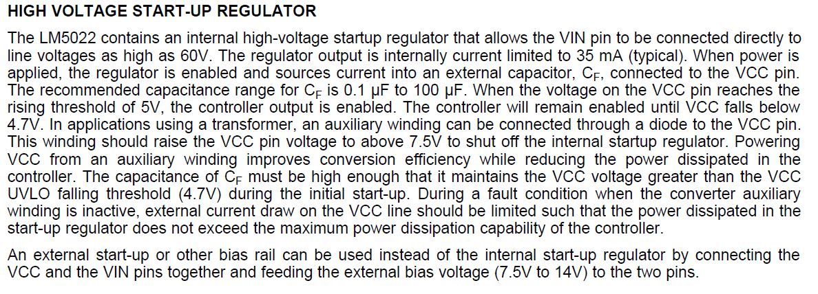

    The main concern with all controllers is the start up where the current is limited by the LDO (See captured section on Startup).   Yes, the driver is capable of supplying 1A by using an external supply feeding the VCC pin.  BTW, LM5022 VSSOP package won't be able to dissipate the power of the LDO supplying 1A. It will fail for thermal.
    Sorry I cannot help with the LM5022 in WEBENCH.  Sounds like the TPS40210 is a good fit, why not just use it.?
  • Hi Howard.
    Yes, LDO power dissipation is essential factor for operating of the IC. BTW, power dissipation calculates in accordance with equations 54 and 55 and is much less than LDO voltage drop with 1A current. Driver has peak value up to 1A and middle approximately 13mA in the datasheet's example. So, power dissipation is a small part of (Vin-Vcc)*1A, isn't it?
