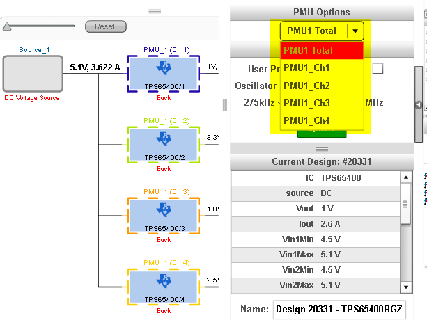

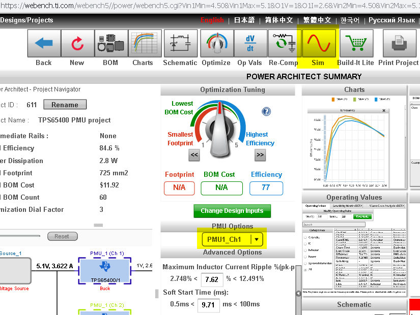

    In order to simulate bode plot, you need to click on a single channel and then click "Sim" tab. Please see attached screenshot below:

    For the simulations, once you click on the channels on the left and then see the Sim button on the top?
    See step below is to click on any channel and then you should observe the sim tab. Bode plot simulation is the first one in the dropdown. Please share your screenshot if you are unable to see this same type of screenshot. Please use the "Attach file" feature to get your screenshot through.

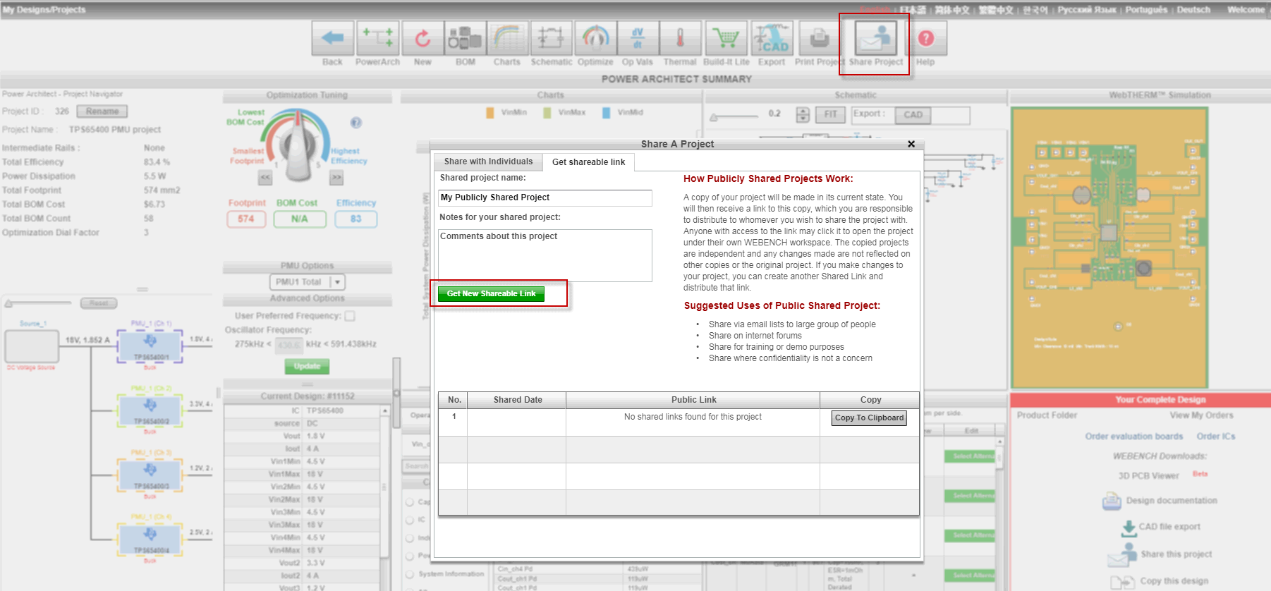

    Also sharing the project is not a problem at all :
    https://webench.ti.com/wb5/OpenPublicSharedProject.jsp?id=E2E34E576E1BDE4A&s=c

    On the sim button: Not sure why the new design has a sim tab. But, if you see it on an individual channel level (TPS65400/1, TPS65400/2, etc.), then you can simulate bode plots on those channels. The results should match very closely with "Opvals" and "Re-Comp" bode plot values.

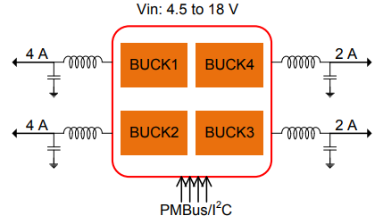

    Kindly note that TPS65400 is PMU IC (Power Management Unit) consisting of 4 Buck channels. Please find below snapshot from Data-sheet FYR.
    WEBENCH also has implemented this device in a similar way where "PMU1 Total" represents total PMU IC whereas "PMU1_CH1", "PMU1_CH2", "PMU1_CH3" and "PMU1_CH4" are the individual channels [BUCK1, BUCK2, BUCK3 and BUCK4] of TPS65400.
    Currently there is no way to run electrical simulation for TPS65400 at system level [i.e PMU1_Total]. Instead you can run Bode simulations for individual channels. Just select any of the channels (Ch1 is selected) in below image and select on "Sim" option [see below image]
