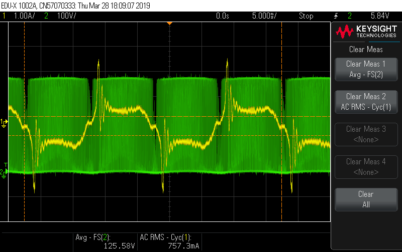

This is kalyan. we are currently working on the TIDA00443 PFC circuit for charger application.
In fixed boost mode we are facing some issues related to input AC current,
for the given AC input ,DC link voltage is maintained at 390V. boost part is working fine,but input current is not sinusoidal (distorted waveform- attached). initially say some 100V AC input ,current waveform looks sinusoidal. beyond that input voltage level current is distorted. herewith i have attached the input current and Isense waveforms for your reference.  what could be the reason for this?
Isense and input AC current
Drain to source voltage and input current
Input AC current
