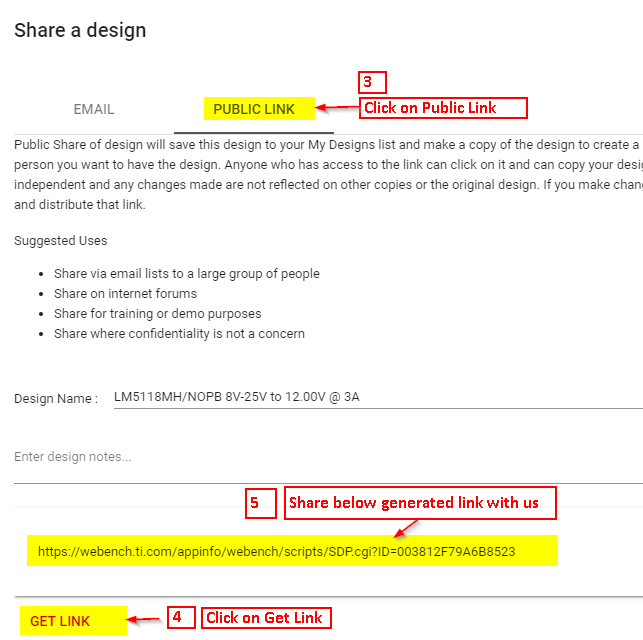

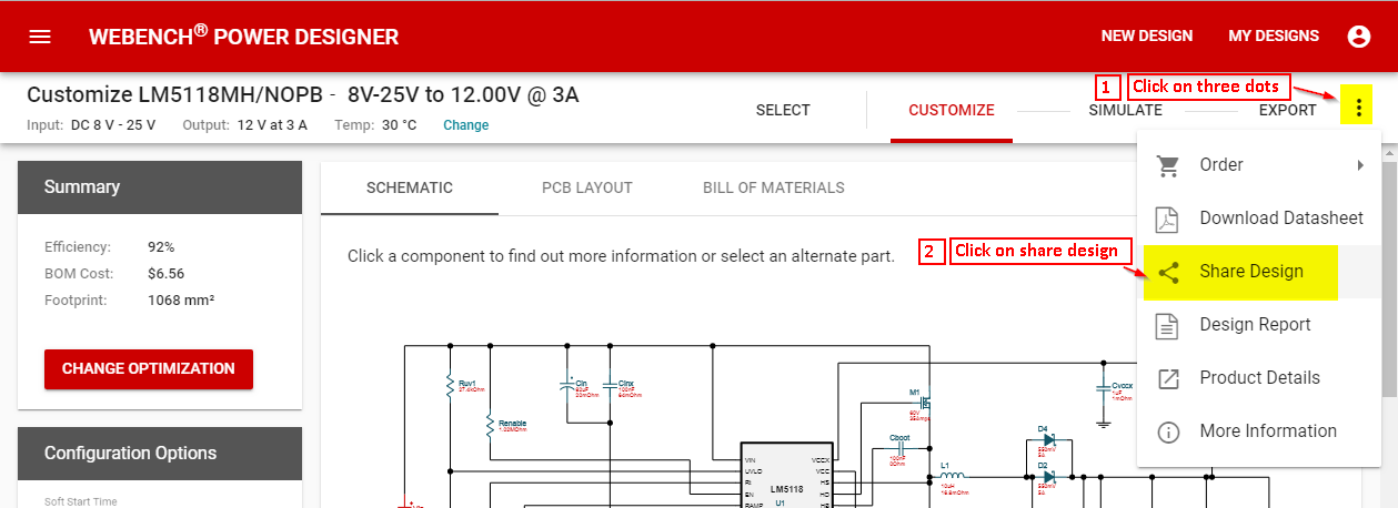

The L1 Inductor in shared schematic is Custom part and Schematic export fails in EAGLE tool if any of the component is Custom in WEBENCH BoM.
Could you please share the your design with us via public link? Please follow below steps.
1. Click on share design.
2. Click on public link and generate the same. Please share the generated link with us.
Bhushan
Thanks for your help on this. Here is the linkhttps://webench.ti.com/appinfo/webench/scripts/SDP.cgi?ID=10B1BB30A231DE8E
