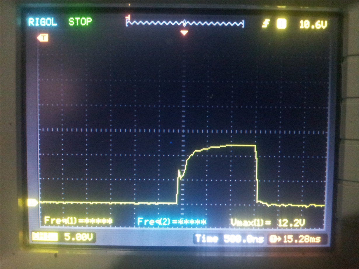

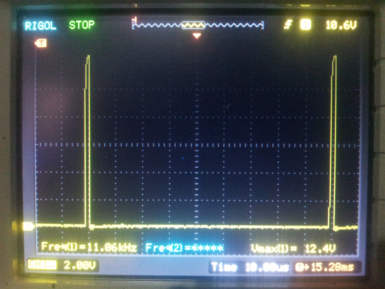

    Tried capturing the MOSFET gate waveform with an oscilloscope: Please find attached images.
    Funny to say, the weirdness as the scope probe was connected between the MOSFET Gate and Ground, the weirdness vanished. (That said, there is still a RESET happening but that's in the order of a few minutes.)
    Could this probably be a decoupling issue ?

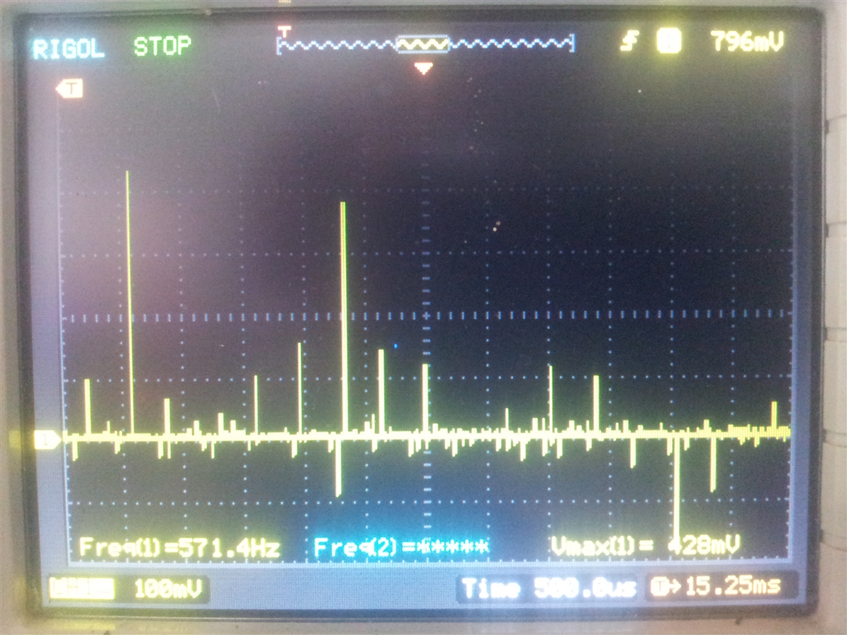

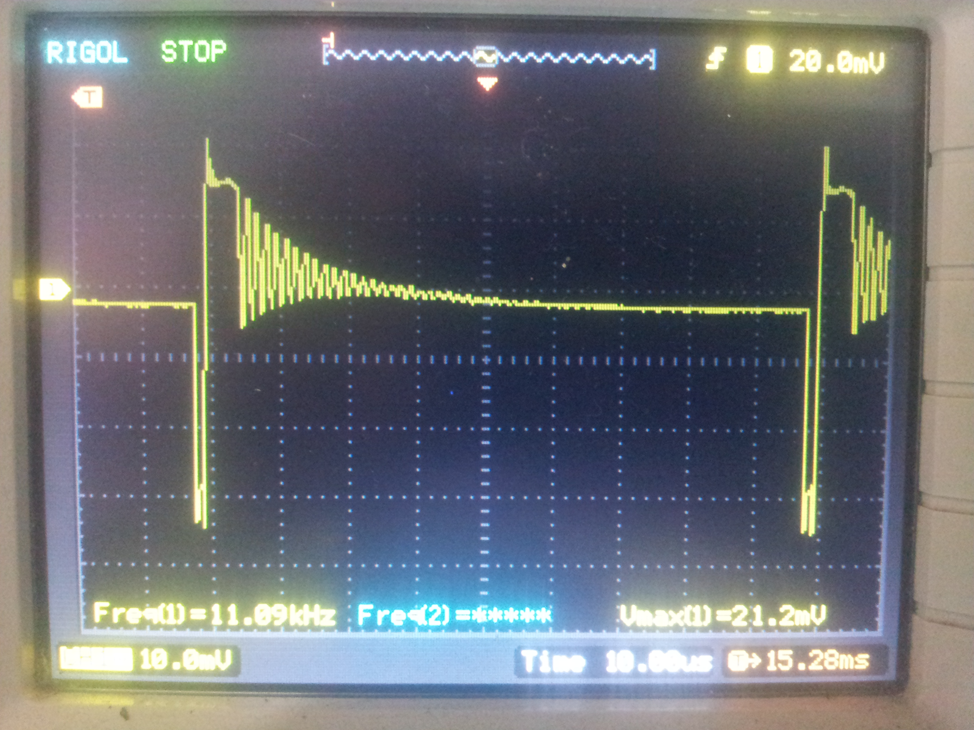

  • Feeling a bit silly replying to my own post, but hoping that someone would reply:

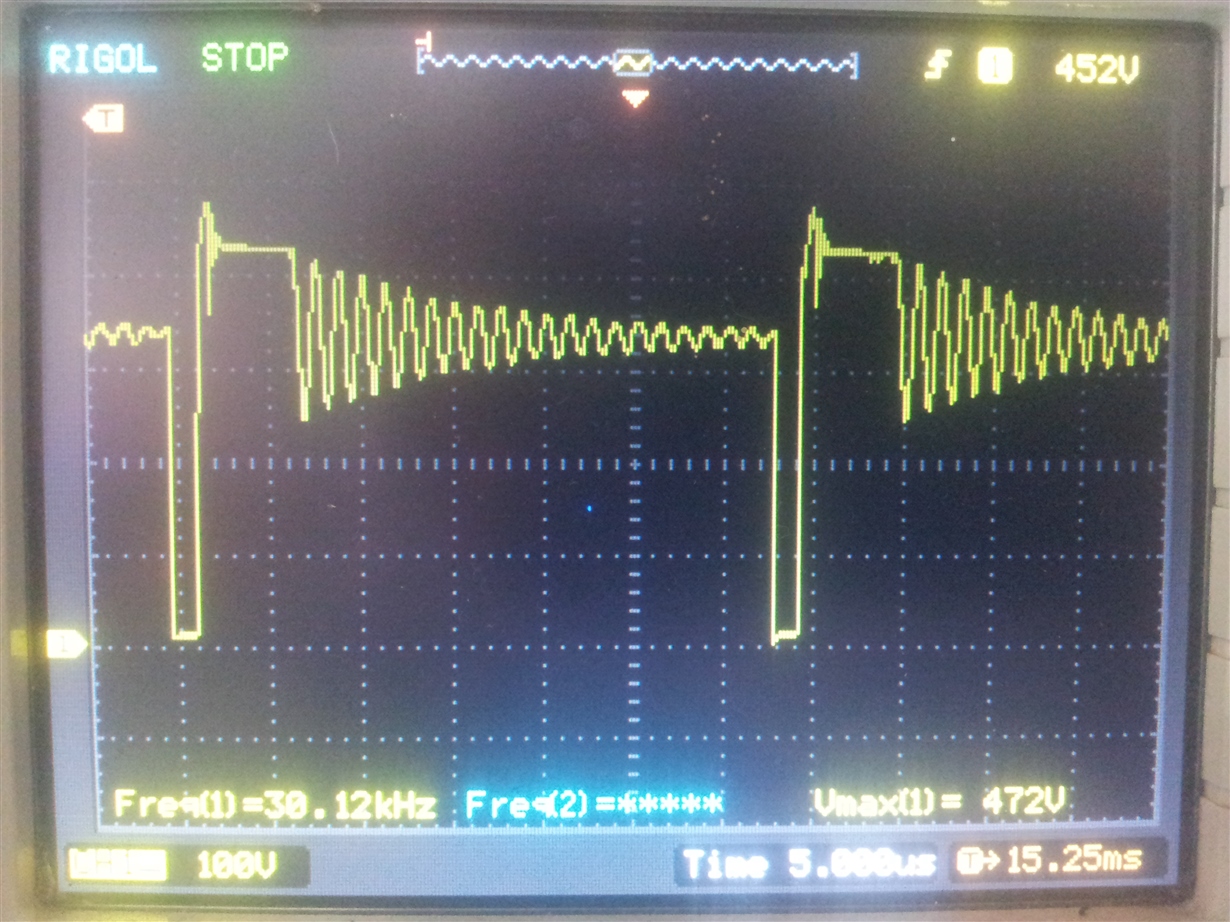

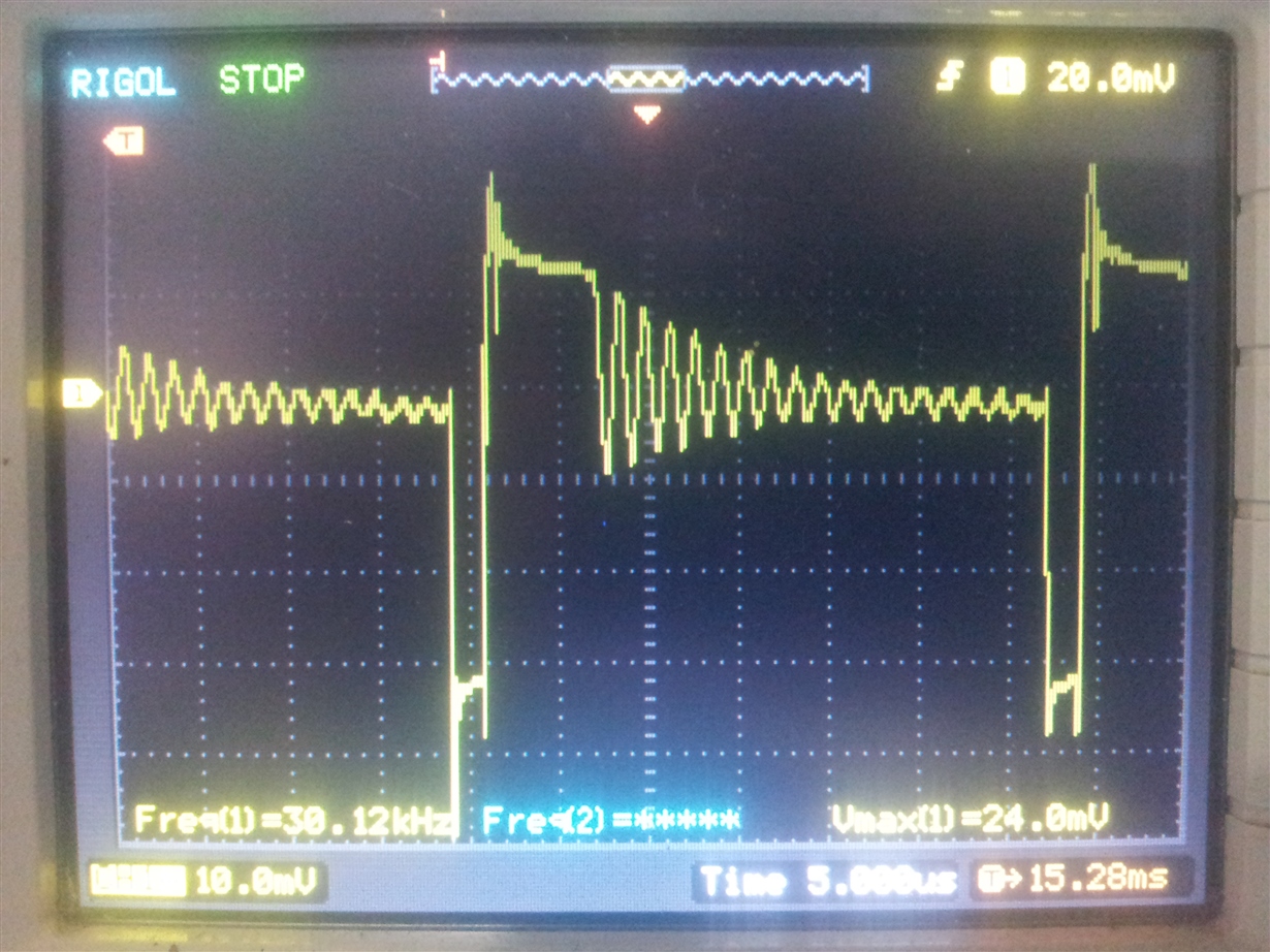

    #1. Measured between C2 GND and T1 GND Pin 11. The spikes are recurring, I guess these spikes are the one RESET ing the C2000 controller eventually. The voltage is between 2 GND ends!. It does look a bit strange, doesn't it ?
    #2.  The voltage waveform at the output of T1 Pin 8

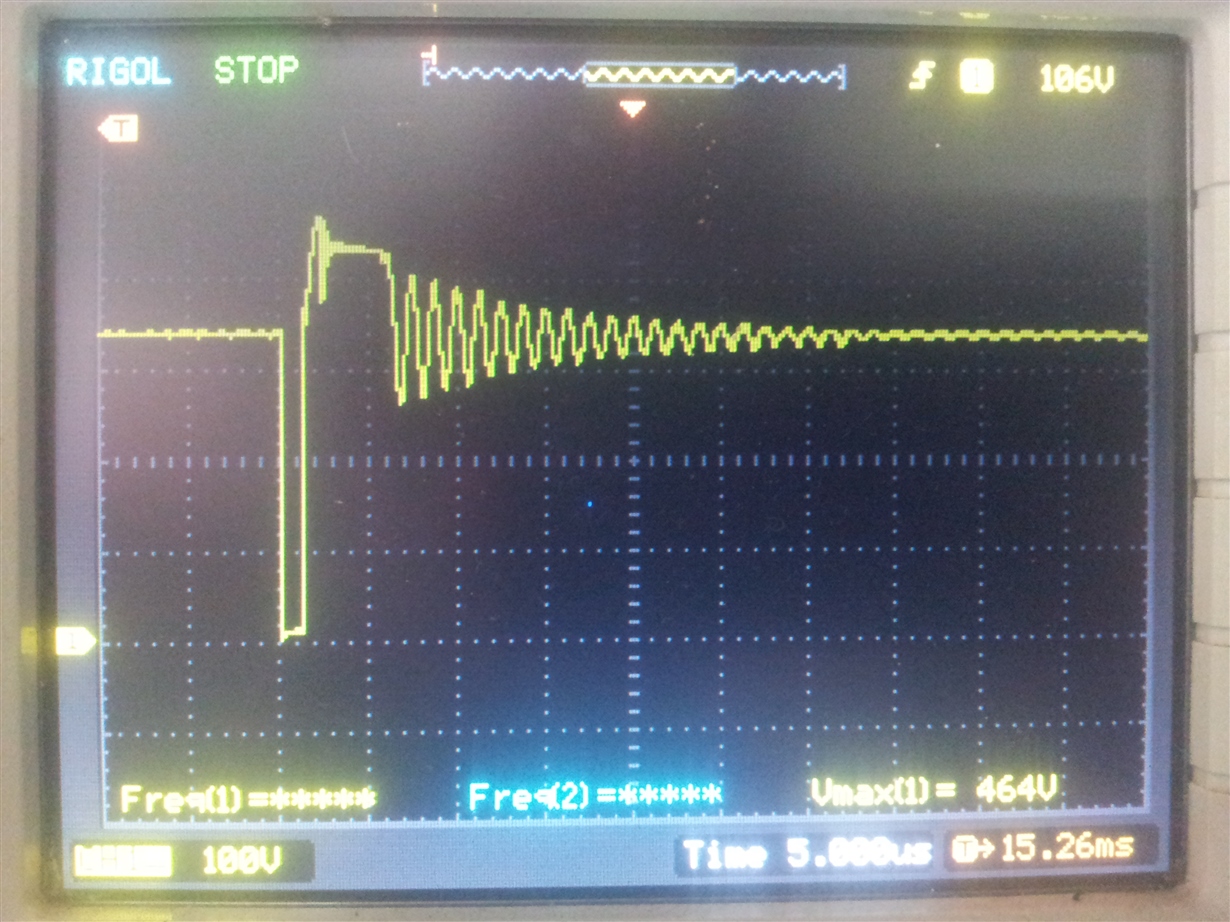

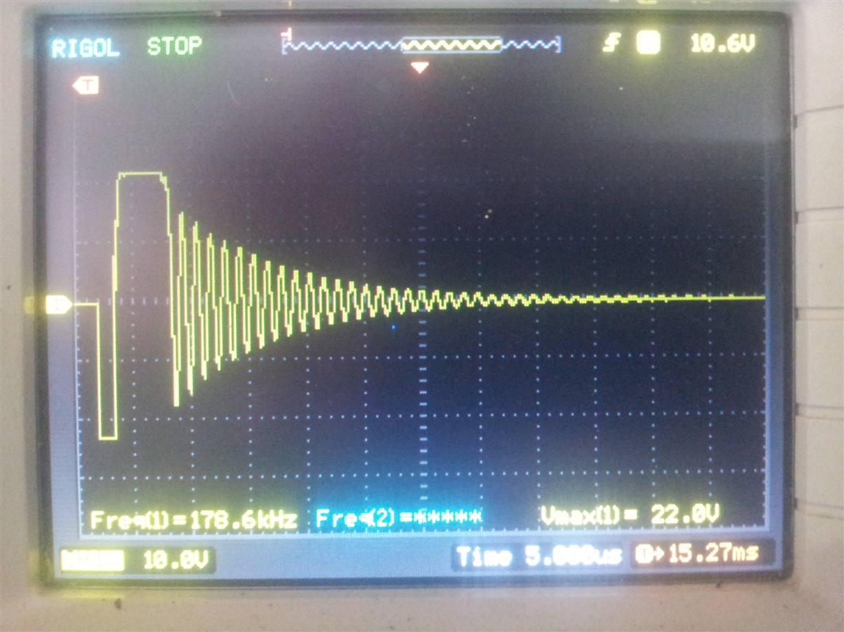

    #3. The MOSFET Drain - PRI GND waveform
    #4. The FET Drain waveform with the LOAD connected and BLDC motor running.

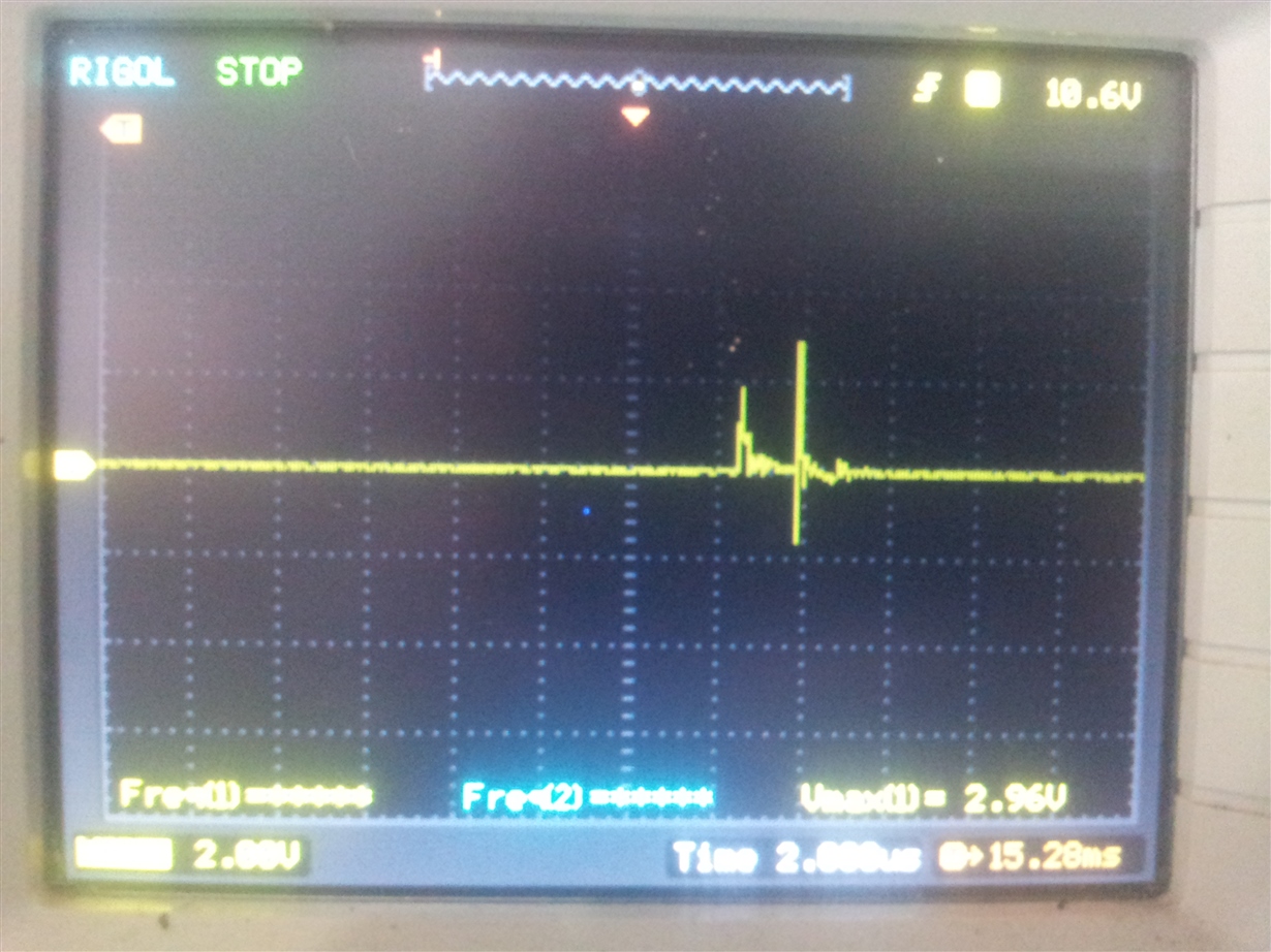

    #5. The same as #1, but after removing C1(1000pf) across the main rectifier D2, with the LOAd connected and running. The noise amplitude seems to have reduced in comparison to #1, but there appears to be more noise ?
    Can someone please have a look ?
    Manu

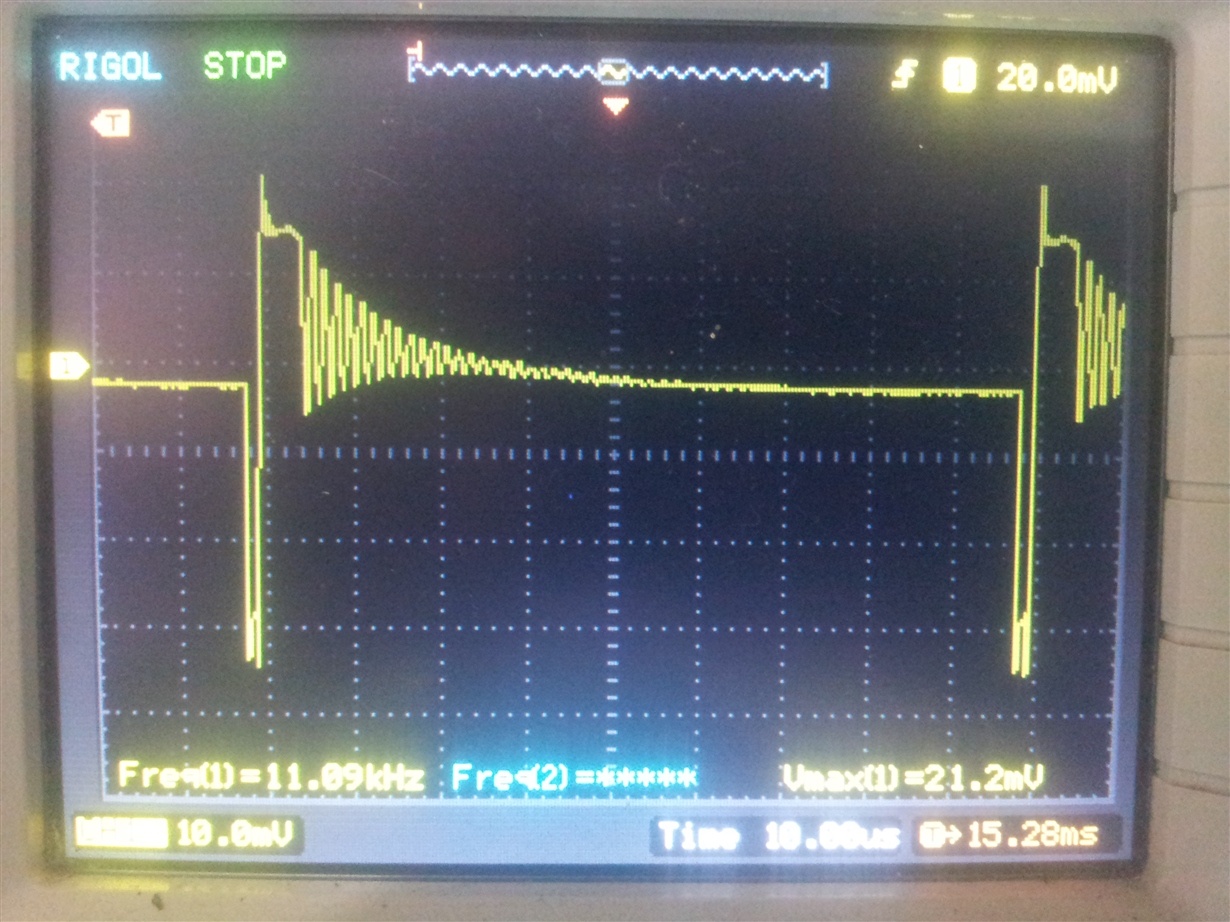

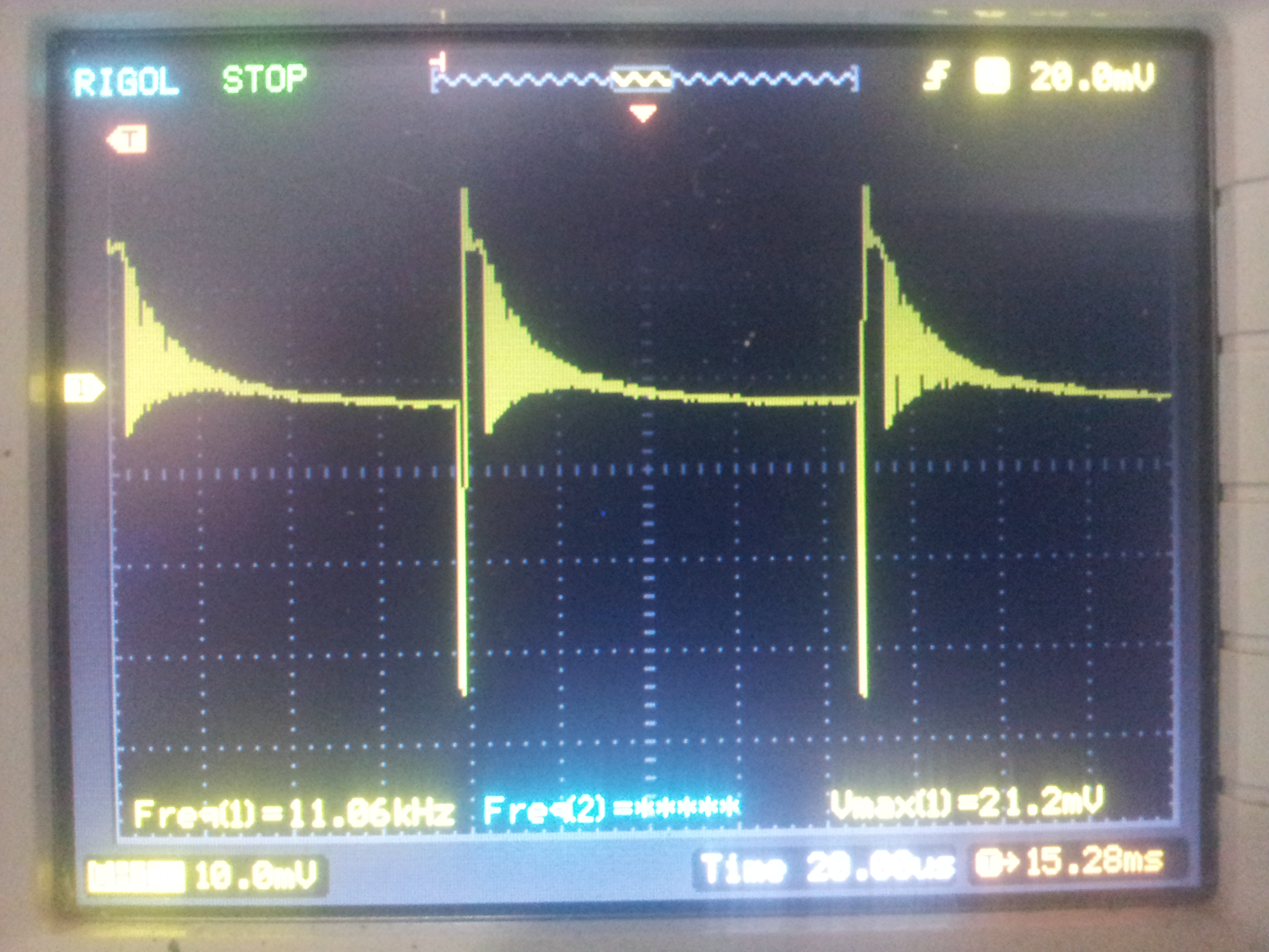

  • An update with a bit more clarification on the situation:
    #1. BLDC running with a 10W lamp load attached. SMPS makes no noise. BLDC runs okay. This setup has a common mode choke in between the SMPS and the setup
    #2. BLDC running *without* the 10W lamp load. SMPS makes noise somewhat like water flowing in a river (with a bit more high freq). BLDC motor runs. The setup has the same common mode choke in between. The controller runs, but the noise transients does cause abnormalities, such that it cycles through settings. The controller has a rotary encoder. The transients simulate the encoder being rotated/changed, which causes the settings to change by itself.
    Measured the voltage waveform across the Current Sense Resistor in both cases.
    Case #1
    Case #2
    Case #2, but expanded waveform
    AFAICS, running the SMPS at 11kHz is causing the problem (audible noise, as well as electrical)
    If I switch RCS from the current 0.12ohms to 0.1358 ohms based on these empirical tests, the SMPS will switch running from 11kHz to 30kHz ?
    (And this change probably solve the issue at hand ?)

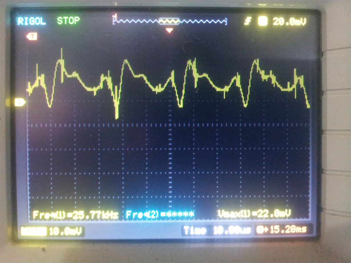

  • Update:
    Changed RCS from 0.12 to 0.15 ohms (the noise increased to a kind of a square wave).  The same abnormality persists, but the rate of abnormality has reduced, but still exists.
    (Without the lamp load) Attached waveform across RCS.
    Yeah the frequency increased from the previous 11kHz. But this change brings in yet another oddity, that it shuts down the SMPS completely. unable to recognize a pattern there. But I guess, the controller assumes Over Current Protection probably ?
