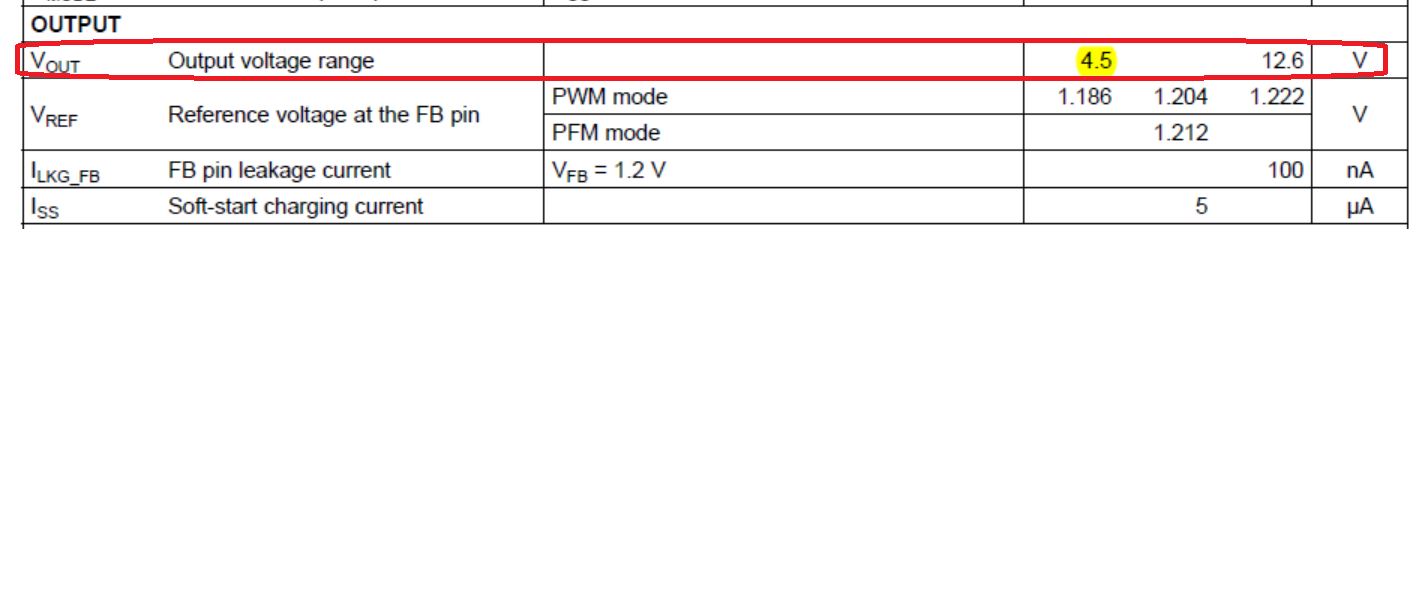

  • Dear Sir,
    Please check the below picture from the datasheet: Vout need to >4.5V, the main reason is to make sure the internal supply voltage is not too low.

  • Hi Saumil,
    It is not conflict.
    1. to get 4V output voltage, we must set the feedback resistor at 4V;
    2. When Vo=4V, the internal supply voltage is not enough(because input voltage also below 4V results low Vcc voltage, Vcc<4V), so we need to find a solution .
    3. To make sure Vcc>4.5V, we need to make  Vin pin voltage >4.5V(because Vo set at 4V, we can't change Vout), for the TPS61088, Vin pin can be seperated with the power input. So we need to found an >4.5V external supply to supply the Vin pin.  Making Vin pin voltage >4.5V, best >5V, then the problem solved.
    4. How to make Vin pin voltage >5V? ...... We found if we add a charge pump circuit, then the Vin pin voltage can be around 2 times the Vout. which is around 8V in this case. So the problem solved!
    noted: charge pump output must connect to the Vin pin, not the Vcc, because the abs max Vcc voltage should be <7V. So it is safe to connect to Vin.
