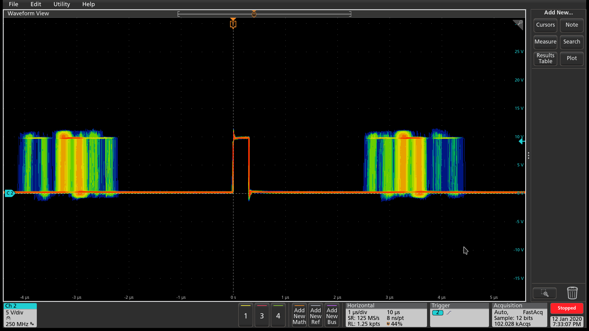

  • HI Gerold, Yuchang,
    I try to adjust the soft-start, it's can be improved.
    But, For VCC1V8 rail ,
    Frequency will exceed 10% ,The settings I have done now are as follows,
    R1391 connect to PG, and change to 49.9k.
    Remove R847, C1094 and C1213.
    PL1 change to 3.3uH
    R1395 Change to 20.5k
    R1397 change to 10k
    Can you help confirm what else can be adjusted?
    thanks,
    Delun

  • Peter,
    Could you help to check U36 "VCC1V8" Rail ? I think the frequency of this rail changes too much.
    I have changed all rails to CCM and I think it can reduce the instability.
    And output 100uF CAP E.S.R.= 4 ohm /each
    Vout= 1.8V  / Ioout=3A
    thanks,
    Delun

  • Delun,
    U36 is a TPS53319 schematic, so when David Daniels asked if there was anything specific about the TPS53319 designs you wanted reviewed, it would have been good to mention this frequency stability question as something you specifically wanted reviewed.
    In D-CAP mode control, the frequency jitter is inversely proportional to the amount of ripple voltage at the feedback node.  For 12V to 1.8V @ 300kHz, the R-C ripple see 5.1uV-s, for 3k driving 100nF, that's 17mV of ramp, which is a good amount of ripple, but the injection circuit has only 1nF driving about 667-ohms of impedance at the FB node, so the DC blocking bandwidth is 238k, to the ramp is getting attenuated and phase-shifted by the DC-blocking.
    I would recommend increasing the feedback resistors R1397 and R1395 to 10k and 20k respectively to increase the feedback impedance and improve the ramp injection.
    With the ramp imposing 17mV on the feedback, that's 48mV at the output voltage.  With 10.8A of peak to peak inductor ripple, which is VERY high for a 3A output, it's emulated and ESR of 4.4mOhms, that's an effective ESR bandwidth of 72kHz with the nominal capacitance.  With 1.8V on a 4V ceramic capacitor, that's likely not enough ramp injection to achieve frequency stability given the high capacitive ripple on the output voltage.
    You can consider a larger inductor, more output capacitance, or more ripple injection to reduce the frequency jitter.
