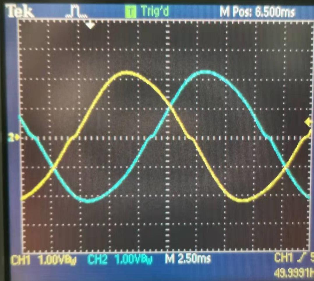

When I tested tida-01606, I encountered the same problem: the sine wave distortion of inverter output after load.
Due to the limitation of conditions, safety is also considered. At present, my DC bus voltage is 48VDC, output three-phase 17vac, with 5.1 ohm pure resistive load.
Waveform distortion found. I don't know what the problem is? Is it because my DC bus voltage is too low or something else.
Hope to get your answer,
Thanks and regards,
No load
15R
5.1R
Hi ,
When testing with lower voltages, can you slightly increase the Kp for the current loop and see if the distortion reduces.
