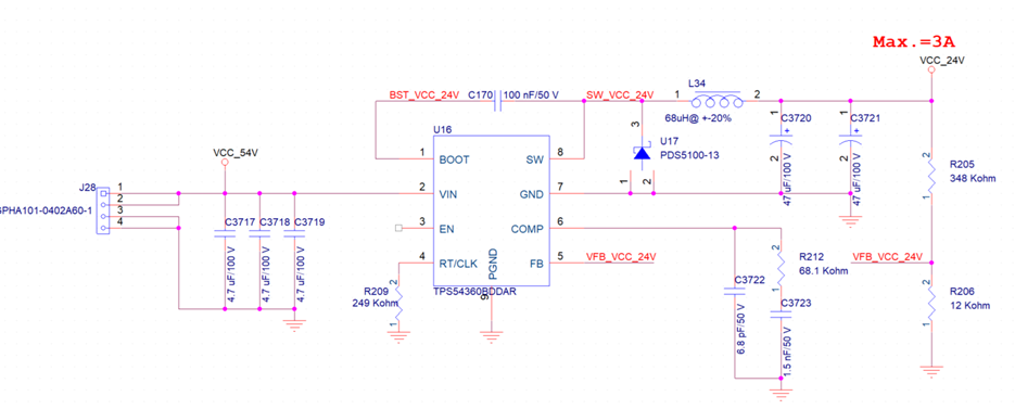

Hi experts,
The schematic RLC value are reference from TI WEBENCH
Input 52 to 56V with 3A output
we have modified the RLC value in EVM board with our design
when loaded with 1A current, the inductor has obviously noise
after increase fequency (RTCLK = 162k), loaded with 2A current, the inductor also has obviously noise
do you have any comment for this issue?

  • Hi Praveen.
    1. 52~56 input, 24V output with 3A, frequency is 391.45KHz
    2. FYR
    https://webench.ti.com/appinfo/webench/scripts/SDP.cgi?ID=6D9E9161919B7256
    3. Yes, we are used  SLVU769B EVM and change RLC value for our design
    4. Vout is 24V and Vin is 54V for 1A and 2A load
    When RT/CLK is 249K ohm, loading with 1A has obviously noise
    When RT/CLK is 162K ohm, loading with 2A has obviously noise

  • Jeremy,
    Can you please explain what you mean by obviously noise? Please share a waveform so we can help diagnose this issue.
    -Sam

  • Jeremy,
    Earlier you said the inductor had audible noise at 1A or 2A depending on switching frequency. Now you say it doesn't have noise up to 2.5A. What has changed in the design?
    How are you measuring the switch node? That measurement looks very noisy. Are you using the tip-and-barrel method?
    The switch node does look unstable. It should be operating at a constant frequency.
    When you say you changed RLC value, do you mean you've updated every component including the compensation network?
    -Sam

  • Jeremy,
    I see that VOUT is collapsing. From the waveforms shown over email, VOUT has large ripple with increases with load (~1.2VP-P at 500mAOUT, ~3.2VP-P at 1.5AOUT, and the waveform you showed above at 2.6AOUT.)
    Simulations show that the design is stable. This makes me think there may be an issue with the layout. Please share the layout and I will review.
    -Sam

  • Sam,
    The major changes is inductor=68uH and output voltage=24V(feedback resistor). We check the inductor current could support up to 6A. The issue occur at higher output current(2.5A). (inductor has noise at output current higher than 1.5A)
