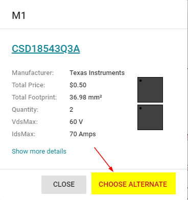

I see two mosfets in parallel on the top part of the H bridge, why is there unequal distribution and can it be replaced by one big mosfet.
Hi Nidhi,
Normally we can observe the parallel fets for high current input cases. This is might be due to the single fet solution for that particular fet is not feasible as it might be hitting maximum junction temperature.
We can always select another fet solution through select alternate option. Please look for fet (M1,M2) quantity equal to 1 and select that solution. I went ahead and created one example work bench for your input case( below link). Hope this helps.
Work bench: https://webench.ti.com/appinfo/webench/scripts/SDP.cgi?ID=FC38F41C0871F167
How to choose alternate Fets:

I changed the mosfets but unable to redue that M1 pair as the junction temperature is being exceeded. I don't understand the voltage being dropped to 21.8V. As I have one of the components which will not be functional below 21.6V. How can I prevent this? Why is the dip seen?
Hi Nidhi,
Could you please try out the workbench which I have shared below ? It has both pairs with quantity 1 mosfets.
Work bench with both pairs of single mosfet: https://webench.ti.com/appinfo/webench/scripts/SDP.cgi?ID=622BD3CBD349A766

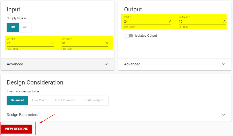

Hi Nidhi,
Currently the fet selection happens as a pair (for synchronous converter) and not as a single fet. The algorithm will check if mosfets as a pair works for the particular input case or not. For your case (LM5175), we will not be able select the fets separately.
But we can always look for alternate solutions as well. Please follow below steps. Hope this helps.
1. Click on below link.
https://webench.ti.com/power-designer/switching-regulator?powerSupply=
2. Add your inputs (Vin, Vout, Iout) and click on view designs. Webench should give you possible list of solutions
Bhushan
