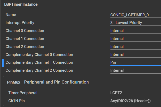

CC2340R5: PWM complementary pin does not has output when used alone
Part Number: CC2340R5

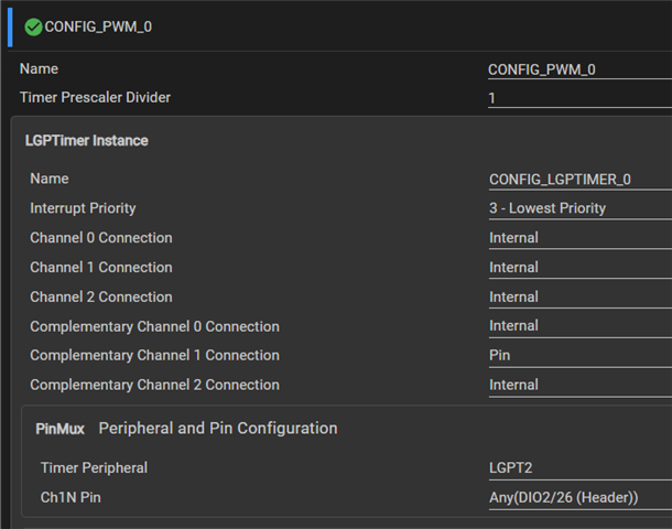

I am trying to output PWM from the complementary channel alone. I found only complementary channel 2 can output PWM without a corresponding channel enabled, while complementary 0 and 1 cannot.

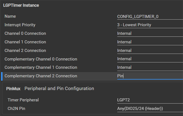

For example, LGPT2 complementary channel 2 can output PWM from DIO25:

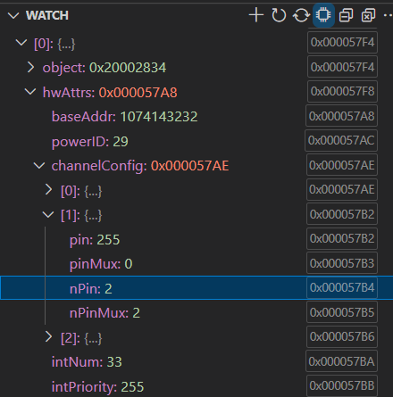

But LGPT2 complementary channel 1 cannot. DIO2 only set to high when it's running:

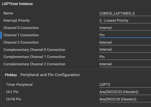

If both LGPT2 channel1 and complementary channel 1 are enabled, both can output PWM:

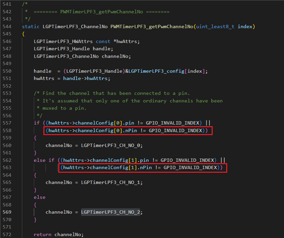

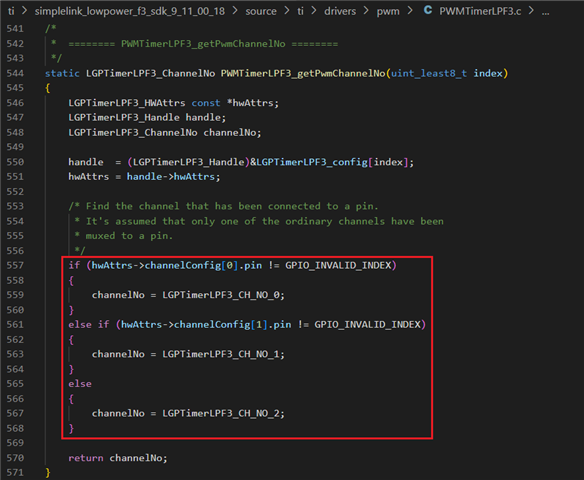

Is this a limitation on the hardware? Or it's a bug in the PWM driver?
