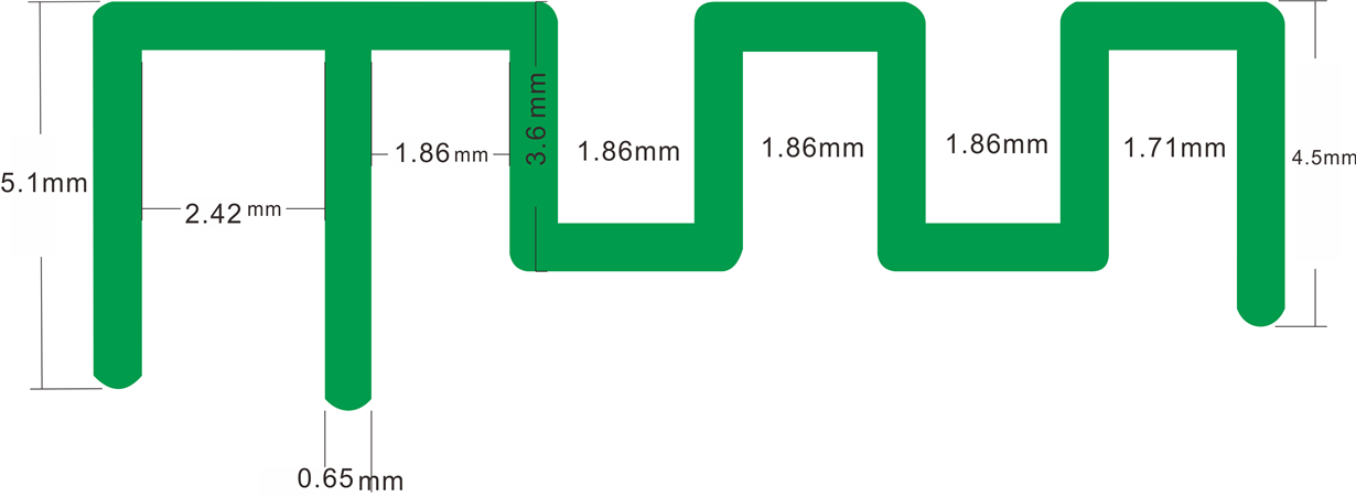

    My workmate who works on program design has a question about “to call the HCI_*_ExtendRange* command in SW”. He told me that he just placed the function, which is named as “HCI_EXT_ExtendRfRangeCmd”, on the last position of the initialization program part for invoking. And he said he didn’t know what SW means and where it is. Is it OK to do so? Would you please tell us the actually correct position to place these codes?
    Second, the attachments are the new relative illustrative electric diagram and the PCB design diagram. Would you please do us a favor to check these files and continue to give us some professional advice? I am still not sure about my new printed antenna design although I have consulted the printed antenna of the TI CC2540 USB Dongle design and other printed antenna designs of some CC2540 application chips. These printed antenna designs are similar but not the same sizes. Would you please tell me the actual referenced sizes of the printed antenna design?

  • See my comments on the layout in the other thread.
    In the schematic (and the layout) you need to connect pins 2, 3, 4 and 5 of the SMA connector together and to ground. L8 should also be connected to ground.
